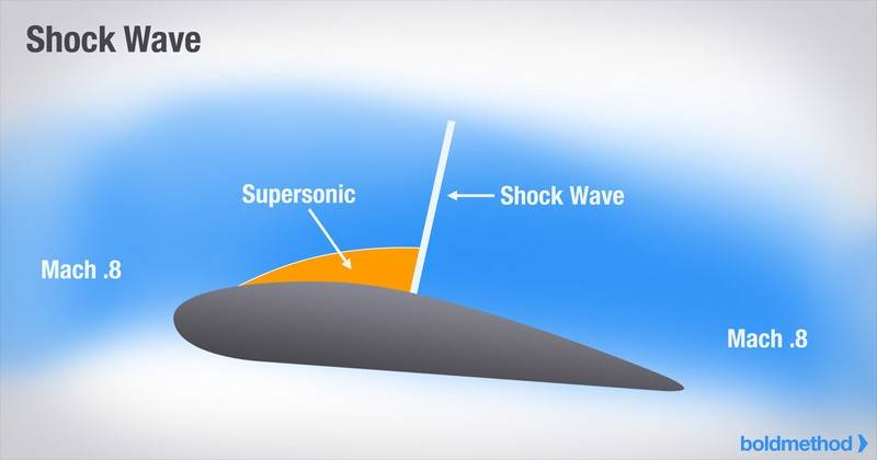

if a airfoil profile has velocity less than 340.29m/s (sea level) but close to this #, the air velocity above the airfoil compresses some and thus has a greater velocity than the airfoil itself (thus an upward force on the airfoil due to pressure diff). if the air above the airfoil has velocity of 350m/s does that air itself make a sonic crack? is this phase the transonic phase where you have super sonic and sub sonic things happening in tandem (one causing the other)?

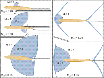

You have it more or less correct. The shock wave occurs where velocity transitions between supersonic and subsonic. As the plane approaches Mach 1, the airflow over the top (and often bottom) surface of the wing is accelerated to Mach 1 first near the top of the wing (the thickest part). At this point, a shock wave forms. As the plane continues to accelerate, the area of supersonic flow moves forward until it reaches the leading edge when the plane reaches Mach 1. See:
And: [sorry if big...]
@russ_watters gave a good explanation of the transonic region. To answer the original question, I would be willing to bet that the shocks there would be unlikely to produce too much of a boom on account of the very low Mach number and the relatively small amount of air involved when only a small part of the flow is supersonic. Any sound from that is likely to dissipate and be too small to notice over the engines anyway.

so for a pointy bullet that is 0.9mach, w/o digging into the math, the airflow around the nose is partially supersonic, but so small it doesn't produce sonic noise.
It would be hard to say with any certainty, but if you had a transonic bullet where it was moving at something like M = 0.9 and had some region that was locally supersonic, I would think it would be a very minute noise. Even a supersonic bullet is just a crack kind of sound, so as you make the Mach number ever closer to 1 and decreases the supersonic region's size, it will tend to get more quiet. I'd say test it to be sure but that would be difficult and (obviously) dangerous to test.
