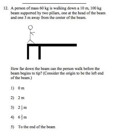

1. Homework Statement
problem is above
sum of torques = I * angular acceleration = 0 for rotational equilibrium
OK, here's what I tried to do.
I wrote sigma Fy = Fleft pier up + F secondleftpierup - Fg,beam = 0
I assumed that the two piers have equal forces, so then I said that
2 * Fsinglepier = Fg,beam
2 * Fsinglepier = 100 kg * 9.8 m/sec^2.
Fsinglepier = 50 * 9.8.
Then I did my rotational equilibrium equation, and I assumed that there was no man in the pier initially. My axis of rotation is at the very left end of the pier:
sum torques = +Fsecondpier [which is 50 * 9.8] * 3 meters - [ 100 kg * 9.8 * 5 meters] (for the center of mass of sphere and the force of gravity acting through it
which gives = -3430 N-m.
This obviously implies that the system is already experiencing a net torque without the man, so the man can not even be on the system to balance it out in any fashion.
The solutions [which might be wrong, due to crummy question authors] say that 3 is the answer without providing any other guidance. Please help, and thanks in advance!
To get the given answer, the second support has to be 4m from the end with the first support.

There is no basis for that assumption. It's incorrect.

Yes, that solution is wrong. As it is, there is no way the man can balance the beam.
How do you know this for the four meters?
I worked backwards from the given answer. Try taking the support as being 1m from the centre of the beam (towards the person) instead of 3m.

Just take the question as you originally posted it, but change the 3m to 1m.

As Billy posted, you have no basis for assuming the forces from the piers are equal. Nobody needs to give you a reason for saying that; the onus is on you to provide a reason for such an assumption.
Indeed, when the system is about to tip the force from one of them must be going to zero.

I did give you a different (and justifiable) assumption to make.
So I can assume that the force from the left most pier becomes zero while the second pier's force is nonzero?
Yes.

OK here's what I have
sumtorques = P2 * 4 - (100 * 9.8 * 5) + (60 * 9.8 *x) = 0
P2 is pier two's force.
the other two terms are the gravitational forces of the pier and the guy respectively. x is the guy's distance from the left point of the structure.
pivor point is left point of the structure.
My question is how can I substitute something for pier2 in now to solve for x.
Thanks!

Two ways to proceed:
- You have only used balance of moments. What other equations are available?
- Choose a reference point for taking moments that makes the force from the pier vanish from the equation.
Summing my equations in the y direction, I have Fpier2 = (force of gravity on pier and on the guy combined) = 9.8 * (100 + 60) = 1568 N.
Plugging the calculated value for P2 in and solving for x, I get x = -2.33 meters which does not physically make sense.

How do you get that? In the first two terms looks like you are taking moments about the left hand end, with anticlockwise positive. The third ...?
Ahh, yess, my bad. Thanks for catching that sign mistake.
I meant:
sumtorques = P2 * 4 - (100 * 9.8 * 5) - (60 * 9.8 *x) = 0

Right. What does that give you for x?
