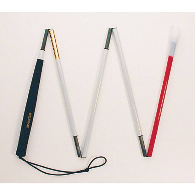

The length problem could likely be solved with a folding cane.
https://lssproducts.com/revolution-advantage-folding-graphite-cane/
If it is too short, by two of them and sacrifice one to add a section to the other one (may need a longer elastic cord though); or maybe you can order one with an added section.

Thanks Tom, that's one of the solutions I've offered to him. I contacted a manufacturer who informed that I could not buy additional lengths, I'd need to get two of them. Which for now should be a very acceptable option.
