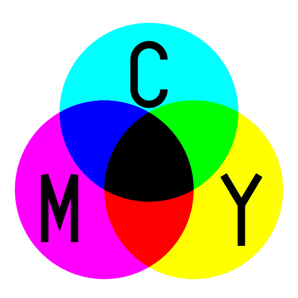

Hello,
When reading a bit about substractive color mixing, a question came up.
I understood that when mixing Cyan, Magenta and Yellow paint, you would get black because all these 3 colors that get reflected by each corresponding paint are absorbed by the other paint in the mix, leaving no color behind to get out of the mix.
Furthermore, it is stated that when mixing only Cyan and Magenta paint, you would get Blue coming out of the paint mix. This is explained by the fact that Cyan consists of a combination of Green and Blue wavelengths while Magenta paint consists of a combination of Blue and Red wavelengths.
Since Cyan paint absorbs the Red part of the Magenta, and Magenta absorbs the Green part of the Cyan, Blue is left behind and comes out of the mix.
Here’s where my question comes up. What if Cyan is not a mix of Blue and Green wavelengts but a pure Cyan wavelength itself? And the same goes for Magenta, having its own wavelength. Doesn’t that mean that when mixing those two colors, you would get black since Cyan absorbs the Magenta wavelength and Magenta absorbs the Cyan wavelength, leaving no color behind to leave the mix?
Yes, in theory the combination of cyan, magenta, and yellow at 100% creates black, meaning all light being absorbed. However in practice due to imperfections in the inks and other limitations of the process, full and equal absorption of the light is not possible so you can't have true black. So, printers for example use the CMYK process adding black (K).
How can this be? You're essentially changing the color models cancelling / interchanging primary / secondary colors. In CMY model, Blue + Green absorbs Red and creates Cyan, Red + Blue absorbs Green and creates Magenta and Green + Red absorbs Blue and creates Yellow. So, this model has primary colors the secondary colors of RGB model.
JohnnyGui said:
... What if Cyan is not a mix of Blue and Green wavelengts but a pure Cyan wavelength itself?
You are talking here of subtractive mixing, so you shouldn't talk of the cyan as a mixture of B & G, but as what is left after R (and O & Y) have been removed from white light or from any other mixture which leaves C and a balance of B&G
Of course, magenta is not a spectral colour and can be seen only as a mixture of R and B light.
Since there is no magenta wavelength to absorb, the cyan must be absorbing the red component of magenta, leaving some blue.
The magenta pigment absorbs colours other than R&B. So the remaining colour is mainly blue.
It's all wrong. Colors are not so simple that you can add and subtract them. Rules about color subtraction are at best heuristics and can and will fail.
Color is what your eye perceives due to stimulation of your cone cells and processed by your brain. Most humans have 3 types of cone cells which have different responsivity curves to different wavelengths. Take a look at the responsivity graph in https://en.wikipedia.org/wiki/Cone_cell
In general, the light coming off an object has a combination of many wavelengths of light. This particular spectrum can excite a particular ratio of your cone cells, and your brain processes the ratio into a color. Different spectra of light can produce the same color in your brain. Two pigments could appear the same color but have totally different spectra and mix in totally different ways.
