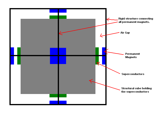

Ok, so I just made a diagram of a better way to do it. How about instead of one superconductor in the center we have 6 superconductors, each next to one of the permanent magnets, and attached to a cube in the center. You really have to see the attachment. Anyways, since the magnets are sufficiently spread out we don't have all these magnetic fields crossing each other, so the superconductor will basically lock in the flux of the magnet next to it. It's like the classic flux pinning experiment, but one on each side of a cube. I can't think of a way this one wouldn't work.

You could also drill holes into each face of the Super Conductor Cube to where it looks like a Die or Dice, instead of dimples, it would have holes, each hole exits out each opposite side so that the Meissner effect can penetrate the Super Conductor Cube from 6 sides, This could help control the flux pinning of the Super Conductor between multiple Magnets by controlling the Meissner effect over and through the Super Conductor. :bugeye:
Depends on what you mean by "work". If you plan on spinning this around, or chucking it in the air, it might not stay suspended any longer. If you subject the device to larger than critical accelerations, you will exceed the critical field that will drive the SC normal.
If you are reasonably gentle with the device, the inner structure will stay suspended.
Also, I imagine your "air gap" is really a cryogen.
I agree with Gokul; the inner structure will stay in place (as in your picture) provided the weight of the inner structure doesn't exceed the combined diamagnetic repulsion of the bottom SC and the flux pinning of the other five.
2ndly, from a practical point, you would need to exchange the location of the magnets vs. the superconductors, (moving the superconductors to the outside frame), so they can be more easily kept in the cryogen without adding additional weight to the inner structure, (a feat which in itself will require the patience of Job:wink:).
Weight is the critical issue, the vector of which changes with rotation, further complicating the levitaton force requirements.
Increasing the diamagnetic repulsion (and pinning) by higher field strength has practical limitations, namely, the magnitude of the B field neccesary to sustain the weight may exceed the critical B and ruin SC.
