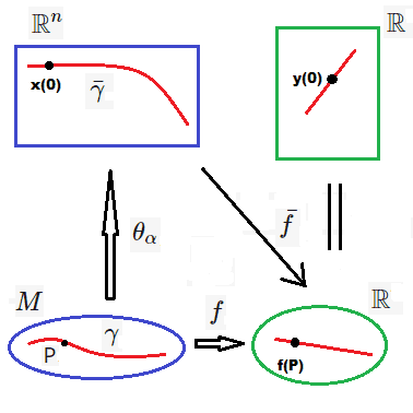

I am trying to understand the following derivation in my lecture notes. Given an n-dimensional manifold ##M## and a parametrized curve ##\gamma : (-\epsilon, \epsilon) \rightarrow M : t \mapsto \gamma(t)##, with ##\gamma(0) = \mathbf{P} \in M##.
Also define an arbitrary (dummy) scalar field ##f = C^{\infty}(M)##, and $$\bar{\gamma} = \phi_\alpha \circ \gamma, \qquad \qquad \bar{f} = f \ \circ \phi_\alpha^{-1}.$$ Here ##\phi_\alpha(\mathbf{P}')## gives the coordinates of the point ##\mathbf{P'}## on the manifold, and ##\phi_\alpha^{-1}## is its inverse. The tangent vector of ##\gamma## at ##\mathbf{P}## is then given as follows, $$\dot{\gamma}(0)f = \frac{d}{dt}(f \ \circ \gamma)|_{t=0} =\frac{d}{dt}(\bar{f} \circ \phi_\alpha \circ \phi_\alpha^{-1} \circ \bar{\gamma})|_{t=0} = \frac{d}{dt}(\bar{f} \circ \bar{\gamma})|_{t=0} = \dot{x}^i(0) \frac{\partial\bar{f}}{\partial x^i}|_{x(0)}.$$
Here ##\dot{x}^i(t) = \bar{\dot{\gamma}}^i(t)## and ##x^i(t) = \bar{\gamma}^i(t)## are coordinates. I understand everything up to this point. Next however the following step is introduced, $$\dot{x}^i(0) \frac{\partial\bar{f}}{\partial x^i}|_{x(0)} = \dot{x}^i(0) \frac{\partial f}{\partial x^i}|_{\gamma(0)}.$$
I cannot understand or derive why this holds. The lhs makes sense to me, since ##\bar{f}## takes coordinates as its arguments, and thus differentiating to coordinates seems logical. However on the rhs we are suddenly differentiating ##f##, which takes a point on the manifold ##\mathbf{P}## as its argument. How can we still derive this to the coordinates? Trying to fill in the definitions of ##\bar{f}## and ##\bar{\gamma}## on the lhs also doesn't seem to take me anywhere. Any help would be greatly appreciated.

After looking into this a little more I agree with you that the equation is actually a definition and not a result. This still confuses me though, what are you actually defining? Aren't all the functions in this case already explicitly defined, so what is there left to choose? It seems odd to me to set two separate things equal "by definition" when these things have already been explicitly defined earlier.
It is always a good idea to make a little drawing of the spaces involved: ##M, \mathbb{R}^n, \mathbb{R}## and the functions between them: ##f, \bar{f}, \theta_\alpha, \gamma,\bar{\gamma}##.
Personally, I would even write ##f:M\longrightarrow N## instead of ##f:M\longrightarrow \mathbb{R}## and name the one coordinate of ##N## as ##y##.

I am not a star at drawing ;) , but I can try to give of an overview of my current intuitive understanding of these functions. Please correct me if something is wrong.
On the manifold ##M##, which I envision as a "curved sheet", there exist points ##\mathbf{P}##. The chart ##\phi_{\alpha}## takes such a point and produces a set of ##n## coordinates belonging to that point, so maps into ##\mathbb{R}^n##.
The function ##f## assigns to each to each point ##\mathbf{P}## on the manifold a certain numerical value, so maps into ##\mathbb{R}##. This function is really just used so that we can define a tangent vector by the rate of change of this function. The function ##\bar{f}## then assigns a numerical value to each set of coordinates.
##\gamma## represents a curve on the manifold ##M##, which I envision as a line on the curved sheet. This function takes a numerical value and produces a certain point on the manifold, so maps into ##M##. The function ##\bar{\gamma}## does the same but produces the set of coordinates belonging to that point, so maps into ##\mathbb{R}^n##.
I wouldn't start with tangent vectors, just the situation at the beginning. That ##f(M)\subseteq \mathbb{R}## is a source of confusion, as we have automatically a trivial chart here, and the function values are indistinguishable from the coordinates: all real numbers. That's why I suggested to use a neutral notation ##f:M \longrightarrow N## and only go back to ##N=\mathbb{R}## if necessary. The drawing doesn't need to be of high accuracy, just as good as to distinguish the spaces. E.g.
I drew the domain of ##f## two dimensional, only to visualize it. This is wrong, as it is only a real line, but then the values of ##f## couldn't be seen.
I read ##\dot{x}^i(0) \left.\dfrac{\partial\bar{f}}{\partial x^i}\right|_{x(0)} = \dot{x}^i(0) \left.\dfrac{\partial f}{\partial x^i}\right|_{\gamma(0)}## as definition and would have written ##\bar{\gamma}(0)## instead of ##x(0)## on the left.
It says basically: We need the chart to calculate the differentiation. But we are interested in a function that ends up in its own chart anyway, so we can avoid the manifold and calculate in coordinates from the start by using ##\bar{f}## instead.

@fresh_42 Thank you! That helps a lot, I feel like my intuition still needs a lot of work in this area but it's getting much clearer already.
