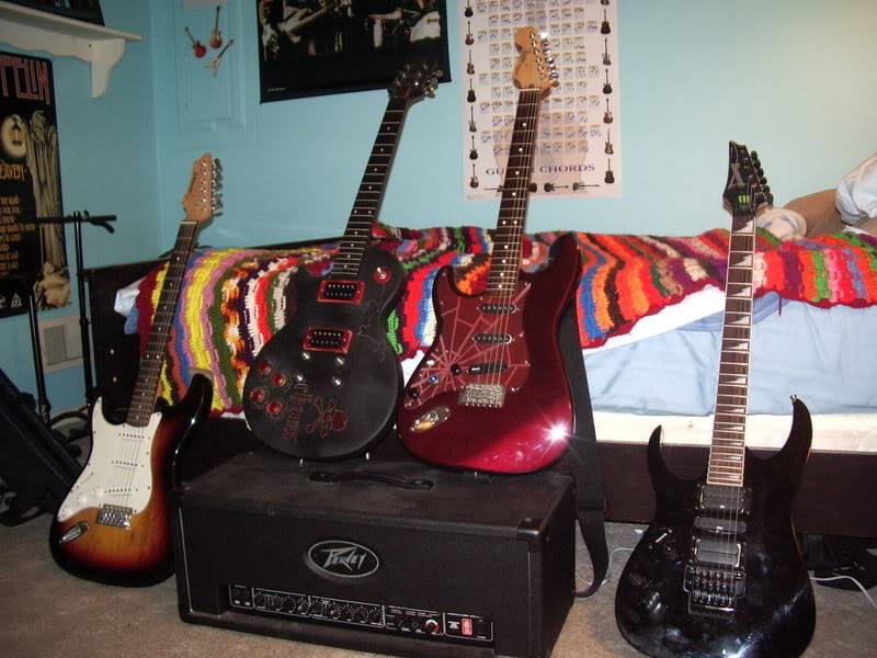

Andy Resnick said:
Do you play anything?
you could say its a hobby...
I must admit that the chords chart surprised me. When I first saw it there, I fully expected to to be a periodic table. :biggrin:
