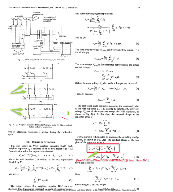

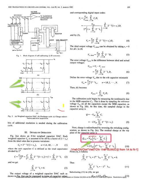

Redistribution of charge principal : How does the negative charge Q redistribute after reconnecting it to a positive voltage Vdd=5V?
Hi folks,
I was trying to understand how the author get the equation (10) that you see in the highlighted page where it is written Vref*CN represent the charge stored within CN which I do not agree for the moment.
so I did a small simulation whith two capacitors C1=2uF and C2=3uF to check if I am right ,I feel like I am right but not the author!!! link to the experiments: two caps charge and discharge
if it was me I would write in the first term of the equation (10) not Vref but [1-CN/Ctotal]*Vref because the charge created by the Cn in Fig 2 (c) is the difference voltage across the CN multiplied by CN!!!!
please help to understand the physics of what is going on at electron level?

Sorry my bad. i want to edit/delete it, but I could not find any way to do it like in other forums? is there a guide for how to use it?
You can edit original post only for a limited time. Please add a better image in a reply and moderators will do some cleaning.
Likes Virmus00 and Steve4Physics
Here it the picture, hopefully it is more clear.
Seems the forums always reduce the quality of the image to reduce the size!!!
