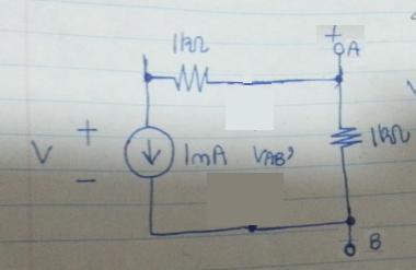

Thanks! Appreciate it. I have another question related to the determination of Vth. I have an example I am doing where the A and B terminals are in the middle. What does one do to determine this Vth then? Because when the terminals are on the left or the right, it makes sense how we are taking a look at this circuit's inner workings. But the confusion is there when it is in between.
Here's a picture of the problem:
https://www.dropbox.com/s/e3tfnt05unozupw/20121207_164124(0).jpg
Well In your diagram A,B terminals are not in the middle.
Because we always can redraw it to this form
And Vth = - 1mA*1KΩ = -1V and Rth = 1KΩ

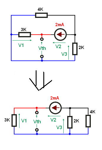

I somewhat understand how we can get Vth to be 6V using the left side of the circuit. Why can't we use the 2mA and the 2kΩ resistor to determine the same Vth?
The answer is that the second Kirchhoff's law doesn't allow us to do so.
Why? I hope that this diagram explains everything
As you can see Vth voltage is equal to
Vht = V2 + V3 and also Vth = V1 (In a parallel circuit, the voltage across each of the components is the same)
therefore
Vth = 2mA * 3KΩ = 6V
That makes perfect sense! Thank you so much :). I truly appreciate it
