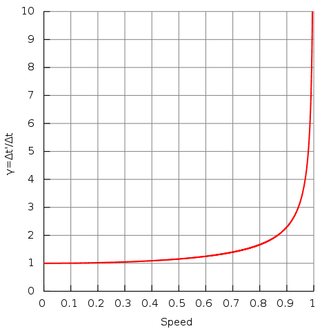

But if we were to be going 65% c (is this how we represent the speed of light?) we would be experiencing time as for every 5 Earth seconds we feel 1 second. ( i don't know the math)
It seems that as you reach close to the speed of light ( this is my interpretation) that the discrepancy between what we perceive as time traveling fast, and what our original resting frame of perceived time, is a big difference.
But it doesn't work like this in the opposite direction? I intuitively feel this doesn't follow a normal pattern of physics (but i know nothing)

Two observers A and B with different speeds, do not see time dilation for the other. Clocks are frequencies, therefore they observe doppler (frequency) shifts, positive if approaching, negative if receding. It's similar to the changing pitch of a sound passing by. The aging (accumulation of time) for each clock can only be done by a comparison of the two at a common location, as was shown in post 5 by harrylin.
If you pass by another clock, decreasing your speed each time, the maximum length tick will occur when you stop next to it. You can't go any slower, i.e., moving clocks will run slower, but never faster. In your above example, the difference would be zero, the clock reads 1.00.
