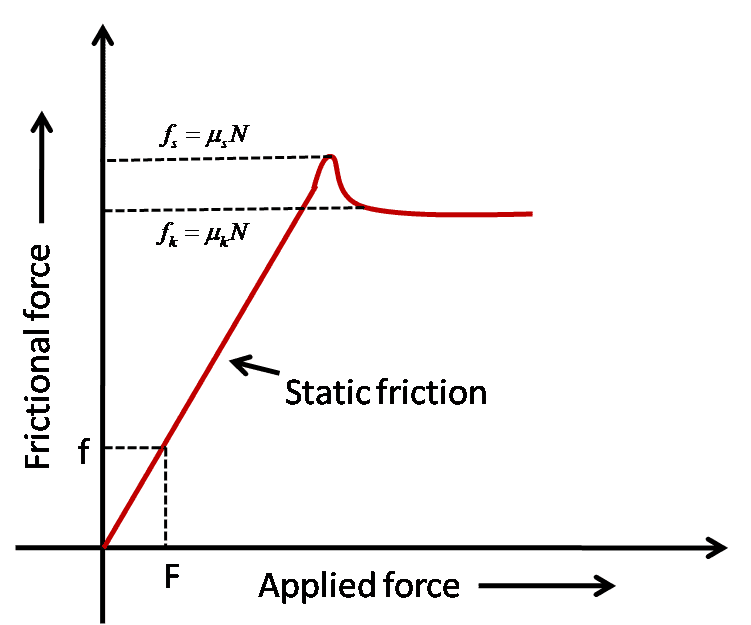

set Force of friction equal to mu · normal force
zstraught said:
... Should I set Force of friction equal to mu · normal force or should I use Newton's second law and set the force of friction equal to Fa·cos(20)? They both look like valid choices, but they both give different values of force of friction.
The second choice is not valid.
You could pull that refrigerator with huge force and still couldn't increase the amount of kinetic friction resisting your effort.
That coefficient of kinetic friction being 0.20 means, in practical terms, that once you get that refrigerator moving and continue pulling it across that horizontal surface, the friction force that resists your pulling remains relatively constant at a value of 20% the weight of the refrigerator.
Please, see:
http://hyperphysics.phy-astr.gsu.edu/hbase/frict2.html#kin
Lnewqban said:
##\dots## the friction force that resists your pulling remains relatively constant at a value of 20% the weight of the refrigerator.
Not quite. The pulling force has a vertical component, therefore the normal force is not equal to the weight.
Likes Lnewqban
Exactly!
Thank you, kuruman.
In this case, the pulling-up angle of 20° reduces the normal and friction forces some, as well as the the horizontal component of the pulling force, which is the one doing the positive work in question.
