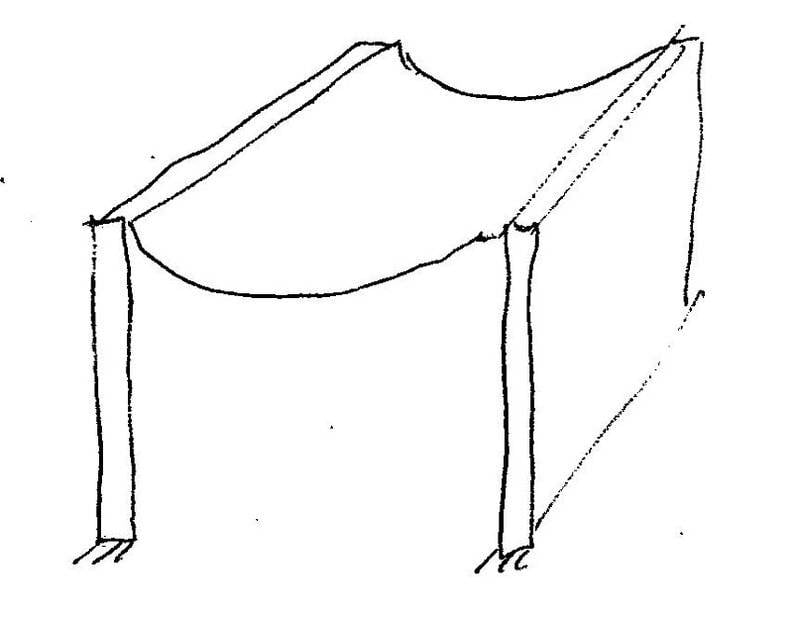

Do you have a picture or diagram of this? How much precision do you need out of these calculations?
I THINK that your description can be summarized by this sketch:
If so, the curve is a catenary (search the term). That assumes that the 10 mbar force (or do you mean pressure?) is evenly distributed over the entire tarp. If these assumptions are correct, then the total vertical force on the walls is equal to the total weight of the tarp plus the 10 mbar pressure. If you carefully measure the angle of the tarp relative to a true horizontal, then the horizontal force is easily calculated. The total force is the vector sum of the vertical and horizontal forces.
A diagram showing the angle would help considerably. Plus your calculation of the total vertical force component.
This is pretty much what it looks like.
The values don't need to be perfectly precise. They serve only as a "minimum requirement" for the strength of the walls/tarp. I did have a structural engineer type this problem into one of his fancy computer tools but I would really like a formula to calculate these forces for different parameters without having to run to the engineer every time I make a change. The vertical force I calculate is pretty close to the values he gave me but the horizontal force is still out a fair bit

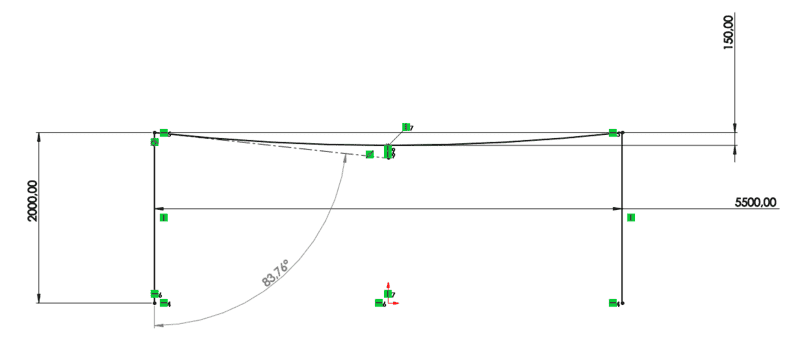

I feel there are some extra details that are necessary to define. When ropes are hanged, they make a catenary shape. In those calculations, the deformation (change in length) of the catenary is not taken into account. Here I feel you have an initially flat tarp and then it deforms to the shape you described that sags 0.15 m. I say so because you didn't mention the original length or shape of the tarp.
On the other hand, if you hang a rope between two poles and the rope has the same length as the distance between poles, the solution gets closer and closer to a straight line with infinite tension if you reach the limit.
Since you provided some information about the sag, assuming the tarp deforms or that it sags because it's got some extra length will give the same result for the procedure shown ahead.
I'd then calculate it assuming a circular shape. From the information you provided, there's only 1 circle that fits so the angle it makes with the wall is constrained. It's possible to obtain the value algebraically but I just drew it.
(Number 2000 is meaningless. I added it just so it's not shown in blue)

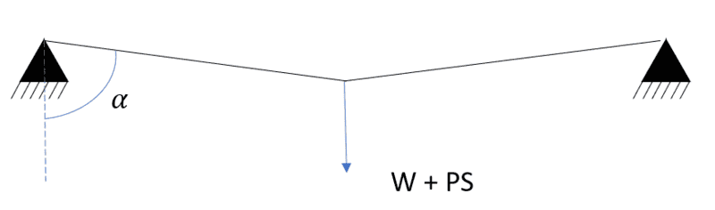

I'd simplify it further to something like this:
Where
##P##: Difference in pressure
##S##: Surface area
##W##: Weight
Since the problem is symmetric, you can apply the equilibrium of forces and find the reactions at the supports/walls. If you parameterize the problem (find ##\alpha## in terms of the sag), you should be able to solve it for many input values using Excel without involving the structural engineer as you suggested in #14.

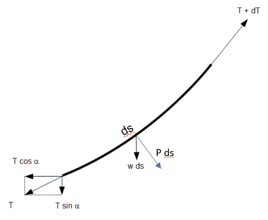

By the way, I also tried deriving the shape from applying equilibrium to an infinitesimal chunk of the tarp/rope similar to how it's done with catenaries but I couldn't get anything useful. This is the picture in case anyone knows how to solve such a thing.
My plan was to follow the same procedure as with catenaries but add the effect of the perpendicular force. I tried finding the center of curvature for that chunk so that I could work out the angle of ##Pds## but it's too hard. By the way, that assumes the tarp does not deform and the sag comes from the tarp being longer than the space between walls.
Still convinced I'd solve it, I tried discretizing the problem and solving it numerically in the time domain with springs and some dissipative force. I was somewhat successful when only gravity is acting but as soon as I input the effect from pressure, the software crashes on me. I've been trying for quite a while but I can't make it work. Here is a pic of the result with only gravity acting on the rope/tarp with unrelated input values.
To sum up, I hope the circular shape approach is enough because I'm out of bullets here.
