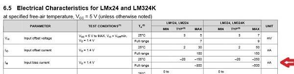

All real amplifiers have at their input pins something called "pump out current"
real amplifiers are not ideal and small current flows into or out of their input pins.
We ignore it to simplify analysis
but we have to deal with it when transferring from thought experiment to hardware. experiment
you'll see the amount of that pump-out current given in the datasheet as "Input Bias Current" but i think pump-out is a better name.
That's why both inputs should see about the same DC resistance to circuit common, and that resistance must be smalll enough to not make significant voltage at bias current as bias current flows through it
Bias currents range from hundreds of nanoamps to femtoamps.

In Figure 4.6, if the 100k resistor were not there the opamp would still draw the bias current, which would charge the capacitor, which causes the input to either go up or down in voltage (depending on polarity of current). This forces a dc offset between + and - inputs, which is amplified by the opamp. Eventually the opamp with be pegged to either the positive or negative rail voltage and your circuit will not operate properly.
At least that is how I remember it going. One of the first hits I got on a google search is here:
