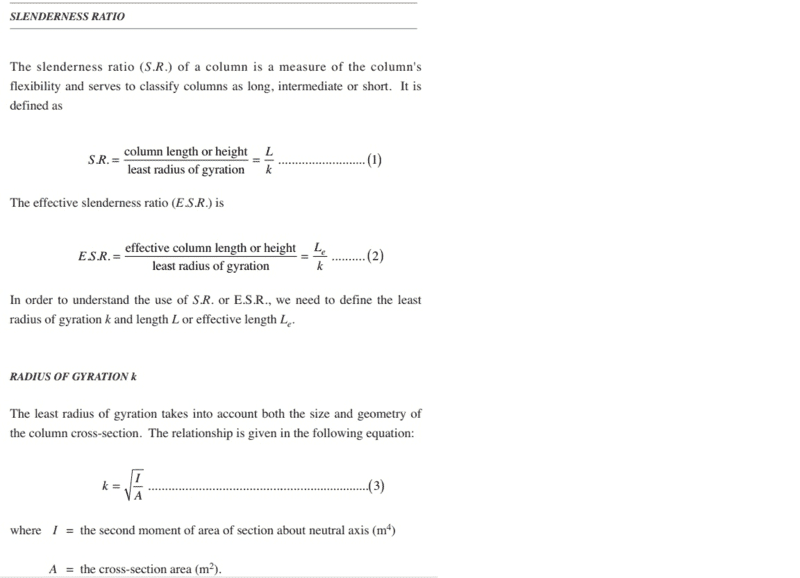

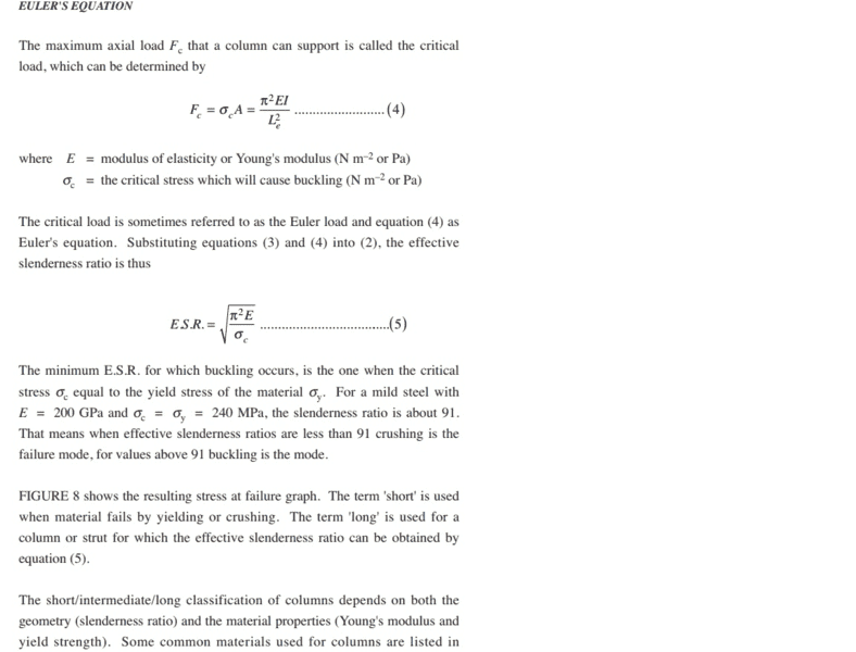

Thank you for the reply and clarification. I have taken a screen shot of a couple of pages from the learning materials which can show you where I get some formulas from and the part about slenderness. In particular the paragraph below the E.S.R. formula on the euler's equation page. This is the one talking about slenderness ratio of a material, i.e. steel, so if I don't know the material being used, does that mean the way it fails will change with different material choices?

Yes. As long as the geometric properties of the column are the same, the material used does not change the ESR. However , since bucking depends on E, and type of failures depends on the yield stress of the material, then it makes a big difference when using other materials. Steel for example has an E modulus about 20 times greater than E for wood, so for a given long length its critical buckling load is 20 times greater than wood. And in terms of the minimum length for buckling at yield stress, the wood , which has a breaking stress about 10 percent that of steel, will buckle at about a half the min length of the steel. Except for short columns, the wood will always buckle before it crushes.
