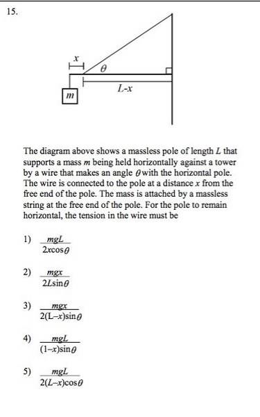

Question on elementary statics multiple choice
In summary, the conversation is about trying to solve for T in an equation involving torques. The attempted solution involved using the equation sum of torques = 0 and resulted in an answer that was not one of the options. The question of whether answer 4) had a typo was raised, and if it did, that would be the correct answer. There was frustration expressed towards the authors of the test questions.

sum of torques = 0
So I tried to put the torques into the equation:
Sum torques = mgL - T *sin(theta) * (L-x) = 0.
Solving for the T gave me [mgL]/[ (L-x) * sin(theta) ]. This is not an option in the answers.
Could anyone please help me out in understanding where I possibly derailed, and why the authors think the answer is 4. Thanks in advance!
What if answer 4) has a typo, and it should read: ##\frac{mgL}{(L-x)sin\, \theta}## ?

If yes, then that is the answer. The test questions are written by some crummy authors [thanks a lot whoever you are!]
