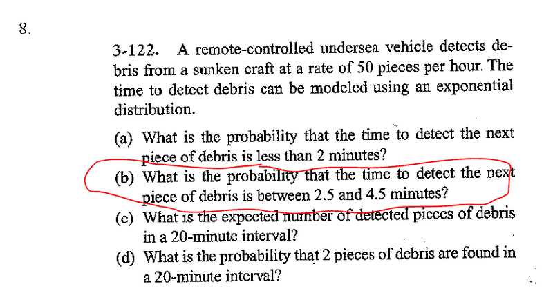

f(x) = eλx/x!
Initially I thought I could solve this problem using the Law of Memoryless. That, the solution would just be P(X <= 2). However, I was wrong. Turns out the solution is P(X <= 4.5) - P(X<= 2.5). Does anyone know why?
First of all the equation you listed is actually a poisson distribution. As the Poisson distribution is discrete, it really wouldn't make sense in this situation.
http://en.wikipedia.org/wiki/Exponential_distribution
The an exponential distribution has pdf of the form:
f(x) = λe-λx for x ≥ 0.
Anyway, what you said isn't quite right.
Turns out the solution is P(X = 4.5) - P(X=2.5)
Since this is a continuous distribution, P(X = 4.5) = 0. In fact, P(X = c) = 0 for any c.
The solution would actually be P(X ≤ 4.5) - P(X ≤ 2.5) = F(4.5) - F(2.5).
Where F(x) is the cumulative distribution function.
The reason for this is that you want X to be less that 4.5, but all the stuff below 2.5 is not wanted , so you subtract off the probability that X is less that 2.5.
