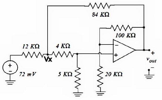

Consider the circuit that attaches in the attachment. Calculate the Vout.
Non-inverting om amp:
Gain = Vout/Vin
= 1 + (Rf+Rs)
Golden Rules:
i- = i+ =0
V- = V+
Gain = Vout/Vin
= 1 + (Rf+Rs)
= 1 + (10/20)
= 6
Vx = (5/4+5) Vin
= 5/9 Vin
Vin = 72mV
KCL:
(Vx - Vin /12K) + (Vx/9K) + (Vx- Vout / 84k) = 0
Vx(1/12k + 1/9k + 1/84k) = (Vin/12k) + (Vout/84k)
[(5/9)(72*10^-3)(1/12k + 1/9k + 1/84k)] - [(72*10^-3)/12k] = (Vout/84k)
Vout = 0.189V
= 189.33 mV
I am interested to know how to find the value of Vx.
Besides, I would like to know is my final answer correct or not.
If not, please kindly point out my mistake.
Your help is very much appreciated
Thank you

Hi Judy9911!
Gain = Vout/Vin
= 1 + (Rf+Rs)
= 1 + (10/20)
= 6
Where did this formula come from? Where are the 10 and 20 data values from?
Vx = (5/4+5) Vin
= 5/9 Vin
After adding an essential set of parentheses, can you explain the derivation of this equation.
For the Gain = Vout/Vin
= 1 + (Rf+Rs)
= 1 + (100/20)
= 6
This is my analysis from the circuit. Sorry that I make mistakes for the equation, should be Rf = 100K ohms , while Rs = 20k ohms
Vx = (5/4+5) Vin
= 5/9 Vin
The bias current of the positive input of the op amp is 0, so the 4k ohms and 5k ohms resistors act as a voltage divider.
= 1 + (Rf+Rs)
= 1 + (100/20)
= 6
Okay. It is customary to reserve ❝Vin❞ to designate the input to the circuit, and not use ❝Vin❞ for some intermediate point.
Vx = (5/4+5) Vin
= 5/9 Vin
Can you take a fresh look at this? Which is greater, Vx or Vin?
It would be better to designate the signal at the non-inverting input as something like v(+) rather than Vin.
You should start by giving symbols (R1, R2 etc.) to all your resistors, then write KCL or KVL & solve the simultaneous equations by Cramer's rule or whatever.
It's not in the exact form of the non-inverting amplifier, so you cannot use that equation in this problem.
Best bet is to use nodal analysis and plug the matrix in MATLAB or something.
Redo this question

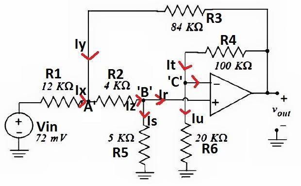

I try to redo this question by using the nodal analysis :
I label my diagram in detail which is attached to this post.
The following is my step to solve for Vout.
Vx= 72mV
At Node'A':
Ix + Iy - Iz = 0
(Vx-Va/12k) + (Vout - Va /84k) - (Va - Vb/4k) = 0 [Equation 1]
At Node 'B':
{ Golden rule: i+ = i- = 0}
Iz - Is = i+ = 0
Iz = Is
(Va - Vb /4k) = (Vb / 5k)
(Va/4k) = (4Vb+5Vb)/5k
5Va = 9Vb [Equation 2]
At Node 'C'
It - Iu = 0
It = Iu
(Vout - Vc)/100k = Vc/20k
Vout/100k = (5Vc + Vc)/20k
Vout = 6Vc
Vc = 1/6 Vout [Equation 3]
{ Golden rule: V+ = V-}
Therefore, Vb = Vc
Sub [Equation 3],
Vb = Vc
= (1/6) Vout [Equation 4]
Sub [Equation 4] into [Equation 2]
5Va = 9(1/6) Vout
Va = 3/10 Vout [Equation 5]
Sub [Equation 5] & [Equation 4] into [Equation 1]
(Vx/12k) - (Va/12k) + (Vout/84k) - (Va /84k) - (Va/4k) + (Vb/4k) = 0
(72m/12k) - ((3/10 Vout)/12k) + (Vout/84k) - ((3/10 Vout)/84k) - ((3/10 Vout)/4k) + (((1/6) Vout)/4k) = 0
5.04 = 42Vout
Vout = 0.12V
Looks right. You conclude with Vout/Vin = 1.667 and that's what I calculated. :smile:

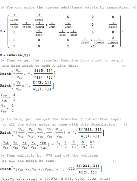

The solution to these sorts of problems can be solved in a very systematic way with linear algebra:
I happened to notice that this circuit exhibits a peculiar behavior. Try analyzing the circuit with an opamp gain of 7 instead of the ideal gain of ∞.
It is peculiar enough that I'm going to start a new thread in the Electrical Engineering forum.
Op amp gain of 7: output = 0.1020V.
What is so peculiar about this? Just change 1 equation, and add 1 more.
I get .0582 volts. Anybody else?
But. actually I meant to explore something else:
Sorry. I spent so much time playing with a small change that I forgot to mention it. I should have said to reverse the v+ and v- terminals (or let the opamp gain be -7 rather than +7).
In the original circuit, exchange the + and - inputs of the opamp but otherwise let the gain still be ∞. If an analysis is performed using the "Golden rules" nothing changes because the golden rule is still just v+ = v-; no distinction is made between the v+ and v- terminals in the "Golden rule". The gain A of the opamp isn't even considered.
But, try this. Obtain a general expression for Vout/Vin in terms of the resistor values and A for the case where the + and - terminals are as shown in the OP's schematic, and also obtain the expression for Vout/Vin with the + and - terminals reversed.
Now take the limit as A→∞ for both cases and note that Vout/Vin is 5/3 in both cases. You get the same transfer function regardless of the orientation of the + and - inputs to the opamp.
