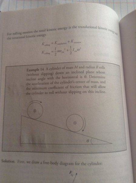

1. Homework Statement
A cylinder of mass M and radius R rolls (without slipping) down an inclined plane whose incline angle with the horizontal is theta. Determine the acceleration of the cylinder's center of mass and the minimum coefficient of friction that will allow the cylinder to roll.
Sigma Torque = moment of inertia * angular acceleration
F = ma
[/B]

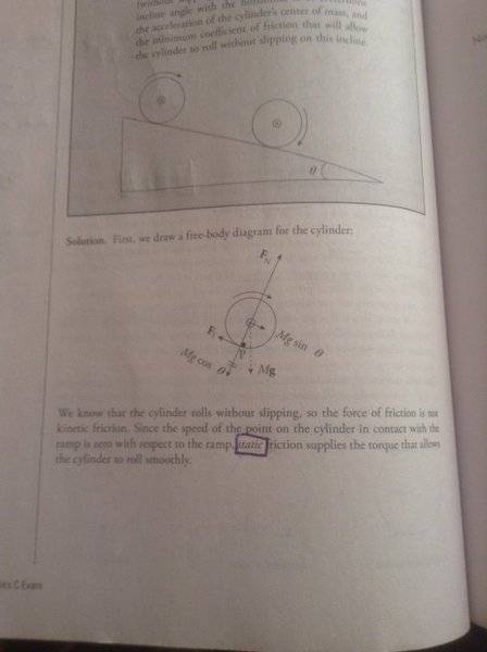

So I am trying to understand this problem and theory, and I am left wondering the following:
  1. Why is it that we can write F = ma equations using the same forces that are used in rotational motion? Mgsin(theta) - Ff = ma?
  2. Why do they say that the "static friction" supplies the torque needed to allow the cylinder roll smoothly?
  3. Why do they take the torque around the contact point to solve for acceleration using the moment of inertia (3*M*R^2)/2 instead of the regular MR^2/2?
  4. Why do they say that the gravitational force Mgsin(theta) is the only one causing the torque when they start doing the math, but say earlier that "static friction supplies the torque that allows the cylinder to roll smoothly?

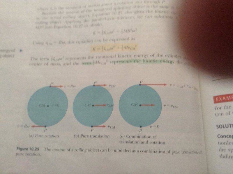

Here is what I mean by the velocity equalling zero. Look at the third diagram. This comes out of the Jewett Textbook.
So if we have a combination of rotational and translational motion... then the velocity at the contact point is zero. So this is where I think I have an instantaneously fixed point and the object is rotating around the contact point P.
Thus, there is no torque by friction , but there is a torque by mgsin(theta). Right?

No. The torque about a given axis due to a given force is the vector product of the force and the displacement from the axis to the point of application of the force. In scalar terms, it's the magnitude of the force multiplied by the perpendicular distance from the axis to the line of action of the force. See https://www.physicsforums.com/insights/frequently-made-errors-mechanics-moments/.
The normal force and the gravitational force both act through the mass centre, so or them the perpendicular distance is zero, and they have no moment about the mass centre.
Likewise, the frictional force and the normal force have no moment about the contact point.
Ahh... I see. So then my mgsin(theta) would not be included but my friction force would be included in the torque expression assuming my axis of rotation is at center of mass
Yes.
