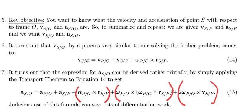

Question on the 3D Kinematics equation.

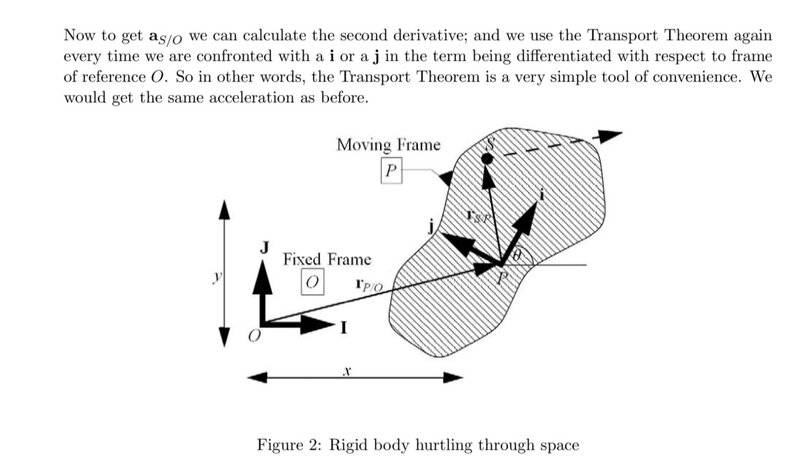

The discussion centers on understanding the transition between two equations in 3D kinematics, specifically how the terms in parentheses of equation (14) relate to equation (15). Participants express confusion about the Transport Theorem, which is crucial for this transition. It is suggested that the theorem, which connects time derivatives in rotating coordinate systems, should be referenced in the textbook used. The relevant sections of the textbook, including diagrams and explanations of the Transport Theorem, are located on pages 4 and 5. Clarifying these concepts is essential for grasping the kinematic equations discussed.
kwnmanu94
How exactly did the terms in parenthesis of the equation (14) become (15)?
I don't even know what the Transport Theorem is about?

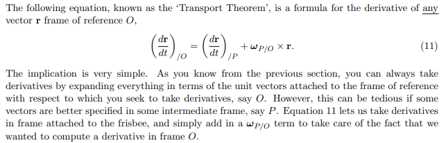

What textbook is this? Since the text directly references Transport Theorem I would expect it to be described earlier. Perhaps look in the index or try compare with transport theorem where you can see it relates the coordinate-wise time derivative of a point coordinated by two different coordinate system that rotate relative to each other.
