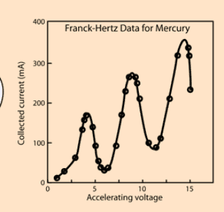

in general the Frank-Hertz experiment showed the discrete nature of atomic transitions. the target atoms were invisible to electrons except for the energies shown below ie for cases like;
what happens if a photon has energy E > E2-E1 ?
Does it interact to the electron anD take it to E2 and the photon loose energy E2-E1 or it doesn't interact at ALL?"the fact the line widths are not infinitely narrow is prolly worthy of a different thread.
reference;
http://hyperphysics.phy-astr.gsu.edu/hbase/FrHz.htmlimage copied from reference above;
