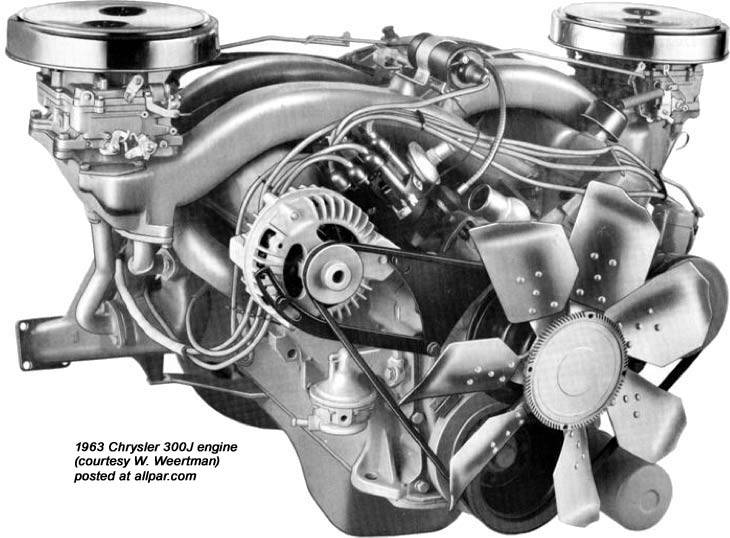

Tuned exhaust is well known to racers, and intakes can be similarly "tuned" to frequency of intake valve opening.
to wit the Chrysler "Ram Induction" intake manifold of around 1960..
inertia of air in those long tubes just might provide a little boost at organ-pipe resonant frequency... ...
