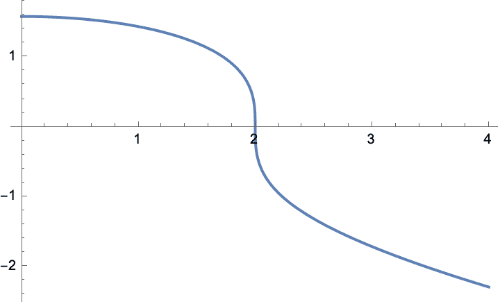

I'm not sure what your Area 2 is. This is the graph of the function I made using Mathematica. Is that what you have?
Yes. Area 2 is everything to the left of that curve below the ##x## axis. It's contiguous with Area 1, which is to the left of that curve above the ##x## axis. The resulting solid would be roughly bell shaped. That was my first thought, but I didn't get the book answer.
The book answer entails Area 3, which is to the right of that curve below the ##x## axis. That fits the problem statement, but seemed unintuitive to me. It's more like two solids joined together.

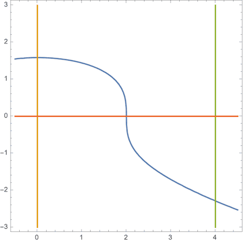

Here's a plot with the four bounds given in the problem. What @PeroK called areas 1 and 3 are the only two areas that are bounded. The problem was to use cylindrical shells to calculate the volume when those areas are rotated about the y-axis.
Likes PeroK

Which areas? I just calculated the volume of the body I get when rotating the blue curve around the ##y##-axis. The question is pretty ambigously stated. Here's another interpretation of the text:
$$V'=\pi \int_0^{4^{1/3}}\mathrm{d} y (4-y^3)+\pi \int_{-12^{1/3}}^0 \mathrm{d} y (12+y^3),$$
and this indeed gives the answer in #1.
