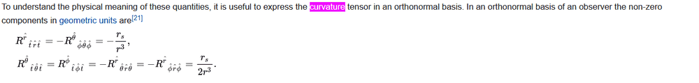

I am guessing (and may certainly be mistaken) that w(r) is related to the spatial curvature.
##w(r)## is related to the extrinsic curvature of the Flamm paraboloid, considered as a 2-surface embedded in Euclidean 3-space.
This is not the same as the intrinsic curvature of a spacelike hypersurface of constant Schwarzschild coordinate time. First, the 2-surface is not the same as the 3-surface. Second, extrinsic curvature is not the same as intrinsic curvature.
The intrinsic curvature of a spacelike hypersurface of constant Schwarzschild coordinate time can't be described by a single number. For a general 3-surface the Riemann curvature tensor has 6 independent components. Spherical symmetry in the Schwarzschild case cuts that down to two, which end up having the same ##r## dependence, namely ##M / r^3##, one just has a factor of ##2## in front of it.
Note that, while this ##r## dependence means the curvature goes to zero as ##r \rightarrow \infty##, the curvature does not increase without bound as ##r \rightarrow 2M##. Again, one should not confuse the extrinsic curvature (which does increase without bound as ##r \rightarrow 2M##) with the intrinsic curvature.

PeterDonis said:
Again, one should not confuse the extrinsic curvature (which does increase without bound as r→2M with the intrinsic curvature ...)
Hi Peter:
Thank you for your post.
I think I understand your post, but I want to make sure.
Your "2M" is intended to refer to rs where you assume G and c to be unit constants. Is this correct?
If this is correct, then the two intrinsic curvature components are rs/r3 and (1/2)rs/r3. Wikipedia
says the Schwartzschild spatial curvature has these two components.
I vaguely remember reading somewhere that for some purposes a single curvature can be calculated as some simple mathematical operation on the product of these two components, but the details fail me, and I am unable to find this again. Do you know of such a relationship?
Regards,
Buzz
Note that that is six non-zero components, not two, and is not using regular Schwarzschild coordinates, in which there are twelve non-zero components of the Riemann tensor.
The scalar invariant you are talking about, ##K##, is the Kretschmann scalar, and is defined as ##K=R_{abcd}R^{abcd}##. The Wikipedia page on it has that written out as eight nested sums starting from the all-lower index Riemann tensor (note that the version you quote above is not the all-lower version).
Yes.
Yes.
Ibix said:
Peter seems to be calculating the curvature of space
I am giving the space-space Riemann tensor components (i.e., those components that do not have a ##t## index). These are components of spacetime curvature, as you say, but they can also be viewed as the spatial curvature of a spacelike surface of constant ##t##.
