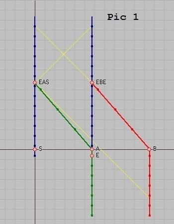

May be, but after EBE send signals to S and EAS sends signal to E, see Pic 1

See pic 1
Which in fact B is already at EBE, but at EAS there's no way for A to know where B is, only after 0.866 years later.
and the time on both clocks should be 0.5 year.
Which clock? A and B?
At EAS, A will see that A's clock is 0.5 year. But still see B clocks as it was 0.866 years later, and because A is changing frame, at EAS, A sees B's clock at -0.7321 year.
See Pic 1, the light ray line (yellow)

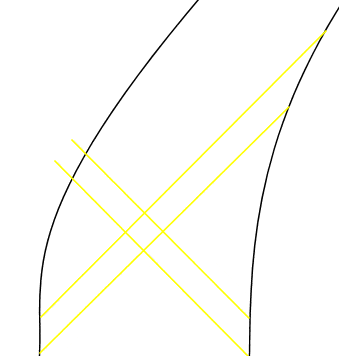

B only see the doppler effect of E. If E keeps sending signal each 1 second, B will receive the signal every
##\sqrt{\frac{1+v}{1-v}} = 3.731 \text{ signals per second, each with E time}## This is doppler factor adjusted by gamma factor. So I was told in this forum. And it makes sense for me.

Perhaps the space time diagram can explain it better to you? See pic 1 and Pic 2So my ultimate question would be where I was wrong and what time the clocks on each object should show, when A first stops at S and also when B first stops at E (if the two events are not simultaneous)
From A and B inertia frame, event EAS and EBE are not simultaneous.
The clocks?
Ok, I'll try to calculate it for you. See the pictures for references. Focus on light ray yellow line.
EAS
A's clock: 0.5 year
S' clock: 1 year
E's clock: 1-0.866 = 0.134 year
B's clock: 1-0.866-0.866 = -0.7321 year
Actual clock:
A's clock: 0.5 year
S' clock: 1 year
E's clock: 1 year
B's clock: 0.5 year
EBE, oops I forgot to draw the light ray TO EBE, ok never mind
A's clock: Now, this is tricky. Has to use cartesian elimination: 0.267 year. Warning: I'm not sure about my calculations perhaps some mentor can step in?
S' clock: 0.134 year: Has tu use cartesian elimination Warning: I'm not sure about my calculations perhaps some mentor can step in?
E's clock: 1 year
B's clock: 0.5 year
Actual clock:
A's clock: 0.5 year
S' clock: 1 year
E's clock: 1 year
B's clock: 0.5 year

Thanks Stephanus, while I am still trying to process your post (It might take a while). I just have a few quick questions first.
"c. Due to the length contraction, E should [add: see] B “jump” 0.433 light year towards E almost instantly,
No, there's no "jump" here. :smile: I have thread asking about it before, see my profile. One - two months ago I have created a lot of thread about basic SR. See if you can find them.
In A moving frame. A moves first. A will deduct that A-B distance is actually expanding.
a. B and A are always on the same inertial frame, as defined,
I think no. The moment A moves, the relative simultaneity of event will dictate that A moves first than B. See Pic 2"
Are you saying there is no way for A and B to move in a way such that A and B keep at same distance all the time, and from another inertial frame (E/S), they will see both A and B accelerating?
I was trying to use the word "jump" to describe the results of almost instant acceleration/deceleration of the spaceships. Of course, if spaceship A and B are accelerating at a much slower speed, E/S will just see spaceship B accelerate at a faster rate then A.

"1 from an observer on Earth E
c. Due to the length contraction, E should B “jump” 0.433 light year towards E almost instantly, and the clock on B should also jump 0.5 year almost instantly. Then B moves at constant speed then decelerates to then stop and both clocks on B should show roughly 1 year has passed and the clock on E should show 0.5 year. (This is the part I think I might I have made some mistakes)
Actually, here I do mean that the clock on B should show roughly 1 year has passed and the clock on E should show 0.5 year, but not the other way around, hence the contradiction I am facing. But as I said, I am not sure what is the proper way to describe what E sees the movement of B during the whole journey.

Janus said:
The problem is that you are trying to assume instantaneous acceleration and that can be confusing.
Instead consider normal acceleration:
As the train gains speed it contracts as seen in the frame of the tracks, [..]
At any point, the distance between the two ends will equal to the length contracted length of the train while moving at that speed.
In the train's frame, the length of the train stays fixed. If we want to look the space time diagram for the train we are stuck with picking a particular "moment" during the acceleration. If we want to see the whole acceleration period we would need to look at a series of images. In each image, the distance between the ends of the train at that instant will always be the same.
Here's the moment close to when the lights emitted when the train started accelerating reach the opposite ends.
I picked this moment as it demonstrates what happens to clocks in the train frame when the train is under acceleration. [..]
Click the up arrow for further reading of that post."1 from an observer on Earth E

I think the title of this thread should Bell paradox" not "Twins paradox"
Stephanus said:
Are you saying there is no way for A and B to move in a way such that A and B keep at same distance [ADD: wrt rest frame] all the time, and from another inertial frame (E/S), they will see both A and B accelerating?
I add wrt rest frame. Is that what you asked?
Sorry, I wasnt clear. what I meant is that spaceship A and B accelerate in a way such that the distance between then as measured by A or B is always the same, i.e. the spaceship A and B are behaving like the train example you talked about later. Basically, consider A as the head and B as the tail and the super long spaceship starts to accelerate, move at constant speed then decelerate etc. Or in other words, the distance between A and B is not constant from an observer on E/S
