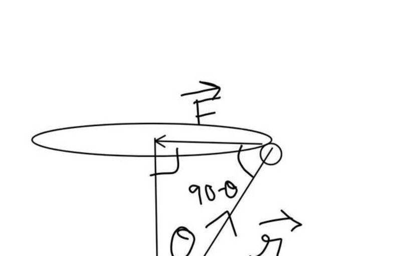

This is the question ,now there are two ways to approach this .
1)Using the formula τ=r×F .
2)Finding L and differentiating it.
Now I approached the problem with the first method .
Since the mass is moving along a circle of radius rsinθ,the centripetal force is F=mrsinθω² ....(1)
https://imgur.com/a/nZogpVO. ...(A)
Here r is the vector from the centre of rod (which is stationery ) to the mass .
Angle between r and F is 90°+θ .
Therefore Torque τ is rFsin(90+

What are you considering r to be?
The vector from point through which the rod is rotating to the mass .
I have drawn r Vector in second image .
