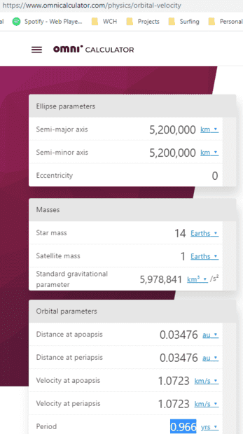

So, does the change the calendar and hours per day for the M2 that we previously discussed?
Did we decide to switch primary P1 from rocky to gaseous?
We'd need to fix its mass to work out the actual orbit before we know the months/years.
As to day length, that's unconstrained. With the huge orbits proposed, tidal-locking would not be an issue.
If we presumed
- the mass of Uranus (14 Earths) for P1,
- the mass of Mars (.1 Earths) for M2, and
- the radius of 5.2 million km (derived post 13), then
I get an orbital period for M2 around P1 equal to 0.966 Earth years.
Anyone care to check my "math"?
Likes LadiSilverfox
