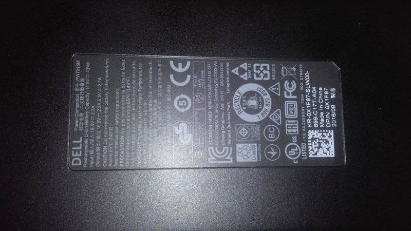

I don't think I missed anything, but I uploaded a picture from the back of the external battery with the specs.

And on the battery itself, it says -
Enargins said:
12000 mAh
14.8V 43 Wh
19.5V 2.3A
?? The datasheet does not say anything about 43Wh @ 14.8V. The datasheet very clearly calls this a 12Ah battery.
Indeed. Hence the immense confusion in this thread. The battery is labeled as 43 Wh with no Ah listed, but the datasheet does the opposite.
Edit: Wait. On the back of the battery, middle right, it clearly says EU 2200 mAh...

That was taken from the information on the back of the external battery. See the picture I attached.
You're right! If EU stands for European Union, then here's a thought. The battery is a 43 WHr battery. In the EU, perhaps they use the maximum voltage (19.5 V) to specify mAh. In the US, though, perhaps they use average voltage (3.7 V) to specify mAh. (That's just speculation on my part.)
Thus, the EU rating is 43/19.5 = 2.2 Ah, whereas the US rating is 43/3.7 = 11.6 Ah, rounded up to 12 Ah (either that, or they used 3.6V and got 12 Ah).
Thus, it could be a difference between which voltage is used -- the maximum voltage, resulting the more-realistic 2.2 Ah, or the average voltage, resulting in the higher 12 Ah.

  • The de-facto standard these days for power input to laptop computers is 19.5VDC. The laptop internally converts this to whatever voltage the internal batteries need to charge. The current the laptop draws is typically between 2A to 5A.
  • According to the "Tech Spec" sheet you supplied, the external battery pack internally has 4 Lithium-Ion cells with a total CURRENT rating of 12000mAh or 12Ah capacity. There is no indication of what the internal VOLTAGE is.
  • If the cells are in series, the nominal internal voltage would be 14.8V, yielding an energy content of 14.8V x 12Ah = 177Wh.
  • If the cells are in parallel the nominal internal voltage would be 3.7V, yielding an energy content of 3.7V x 12Ah = 44Wh. This matches the rating of 43Wh stated in post #1, copied from the back of the battery.
  • Therefore there are four 3Ah cells wired in parallel for 12000mAh at 3.7v, yielding 4x3x3.7 = 44Wh
All the above relates to the amount of energy the external pack can store.Now the pack has some internal voltage converters to supply the 5V USB outputs and to supply the 19.5V to recharge the laptop.
The 19.5V output has a maximum current capability of 2.3A. This is 44.8W, or at full load about 1 hour to full discharge, if there is no load on the USB outputs.
Conclusion: Even though it is scattered, all the information is supplied. Probably doesn't reach 'False Advertising' level, but is certainly obfuscated and misleading.
p.s. I have no idea where the 14.8V comes from on the battery sticker ( as shown in post #1)
