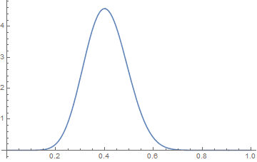

As long as it is clear that both approaches require a realistic understanding of the assumptions involved and are used judiciously. Neither can give a mathematically rigorous answer in the form of a probability unless some bold assumptions are made.
Buzz Bloom said:
I would much appreiate it if someone would post a simple example of how Bayesian statistics calculates an error range and confidence level.
Probably the simplest example is for estimating the probability of success for a series of Bernoulli trials (e.g. estimating how fair a coin is by flipping it a lot).
For the Bayesian approach it is pretty straightforward. If you have ##n## trials with ##s## successes and ##f=n-s## failures then you describe the rate of success as a random variable ##p\sim Beta(s+1,f+1)##. Since you have a probability distribution for the success rate ##p## then you can do everything that you can do with probability distributions, including finding the mean, estimating quantiles, and calculating interval probabilities.
For example if you do 30 trials and get 12 successes and 18 failures, then you would have ##p\sim Beta(13,19)## which is plotted below. The mean of this distribution is 0.41 and the 0.025 quantile is 0.25 and the 0.975 quantile is 0.58. This means that there is a 0.95 probability that the success rate is between 0.25 and 0.58.
For the frequentist approach it is less straightforward. You can find an estimator ##\hat p = s/n## of the unknown true probability ##p## which is not treated as a random variable. Because ##p## is not a random variable you cannot take its mean, but you can assume values for ##p## and use the Binomial distribution to predict how likely you are to see ##s## successes in ##n## trials and therefore you can get a likelihood function for ##\hat p##. When you do that then you can estimate the probability of getting a ##\hat p## value that is more extreme than the observed value under any given hypothesis, such as the hypothesis that ##p=0.5##. A 95% confidence interval is then an interval that should contain 95% of the estimates of ##\hat p## under that assumption if you repeated the exact experiment many many times.
For the above example, ##\hat p = 0.40## and the 95% confidence interval is ##[0.22,0.58]##, which is pretty similar to the Bayesian estimate.
For the Bayesian approach it is pretty straightforward. If you have n trials with s successes and f=n−s failures then you describe the rate of success as a random variable p∼Beta(s+1,f+1).
Hi Dale:
Thank you for your example. What I am missing is what makes the method of a series of trials Bayesian. Perhaps I misunderstand, but my understanding of the Bayesian method involves conditional probabilities and priors. Your example had neither of these concepts.
I am also confused by the use of the Beta function:
Beta(s+1,f+1) = s! f! / (s+f+1)! .​
Properties section.​
I would have thought you want the reciprocal of the combinations distribution
1/Comb(s,f) = s! f! / (s+f)! .​
I get that for large n these two are approximately the same, but I do not understand the preference for the Beta form.
Sorry, I tried to avoid “jargon” and perhaps overdid it. I used an uninformative prior (a uniform distribution=Beta(1,1)). The plotted distribution is the posterior probability which is the conditional probability of the hypothesis given the data.
It is not the beta function, it is the beta distribution: https://en.m.wikipedia.org/wiki/Beta_distribution
The Beta distribution is the conjugate prior for a Bernoulli trial.

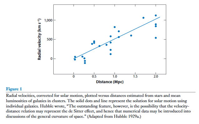

Hi @Stephen Tashi, @Orodruin, @FactChecker, and @Dale:
I want to thank you again for all your help in educating me about my question in the OP. One thing in particular I learned is that Bayesian statistics is a great deal more complicated than I thought it would be. My original understanding was limited to just Bayes Theorem.
I still feel I have failed to learn what my original question was seeking. I would like to try one more example, this one involving a best fit problem from 1929.
The figure has 24 dots, each representing a distance D and a velocity V corresponding to a galaxy. The straight line represent a simple form of the Hubble equation:
V = h0 D .​
Presumable h0 is calculated by a suitable best fit method minimizing the sum S of the squares of the 24 error velocities:
S = ∑[i=1 to 24] (Vi - H0D)2 .​
One method of doing this is to calculate the value h0 which satisfies the equation
dS/dh0 = 0 .​
That would give a value for h0 as a mean of a distribution of possible h0 values. However, additional work is needed to get a value for a standard deviation. I have a method in mind for how this might be done, but it is somewhat complicated, and I think I should it omit it from the discussion unless someone would particularly like to see it. I interpret the method I have in mind for calculating the standard deviation as frequentist. The method I described above as producing a mean I do not think of as involving any statistics.
How would a calculation be made using Bayesian methods leading to a value for a mean and standard deviation for a distribution of possible h0 values? What would the conditional probabilities and priors be?
Regards,
Buzz
dS/dh0 = 0 .​
Why does it give a mean value of ##h_0##? Applying the least squares fitting procedure to a set of data doesn't produce other "possible ##h_0## values". So there isn't any distribution of ##h_0## values.
A difficulty in converting this example to a Bayesian confidence interval example is that, as example of frequentist, reasoning, it is complicated. If you think about it, the fitting procedure will produce one single value for ##h_0##. So how is it possible for ##h_0## to have any standard deviation? How do we attribute a standard deviation to a single number? Computer software that outputs standard deviations for parameters obtained from fits must use various assumptions and approximations to estimate a standard deviation for ##h_0##.
The conceptually simplest method is to use estimated statistical properties of the data to generate simulated data and use the varying values of ##h_0## obtained by fits to the simulated data to estimate the variability of ##h_0##. I would call this a Bayesian approach because assumptions about the statistical properties of the data implictly determine a statistical distribution for ##h_0##.
A different method is to make the assumptions that allow the use of a "linear asymptotic" estimator for ##h_0##. I don't know if pure frequentist reasoning can be used to justify that technique.
