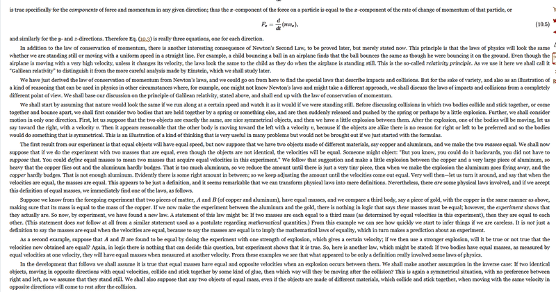

(From the paragraphs after equation 10.5)
'It is not just a definition to say the masses are equal when the velocities are equal, because to say the masses are equal is to imply the mathematical laws of equality, which in turn makes a prediction about an experiment.'
I am trying to understand about laws which Feynman is trying to explain.
1. What are mere definitions he is mentioning and what are laws?
2. Can anybody give me more examples like this where its not just definition but law where through mathematical laws there are predictions about an experiment which would produce new laws?
He is just saying as I understand is that if say we define something like if the velocities are equal after explosion then the masses are equal too. Now if we experiment with A and B and then with A and C and establish that they are equal masses then by mathematical law of equality it is suggesting to check with an experiment that whether B=C. And it is. So there is a new law which says if two masses are equal to a common mass then they are equal to each other. And this new law is obtained by our definition. So that is not just a definition any more but a physics law.
