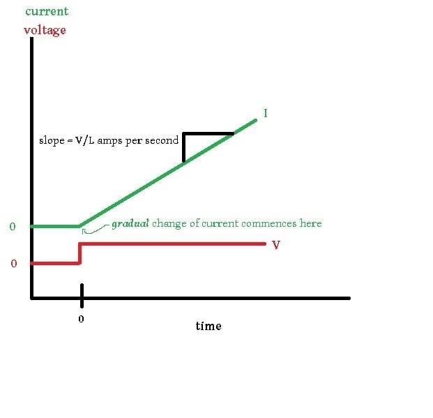

AASHISH SRIVASTAVA said:
Now in fig 2 let the switch is closed at t=0, current flows and a magnetic field sets-up, this magnetic field produces back emf and so current stops at t=0+ and the inductor behaves as open circuit
That's just plain wrong.
Back EMF is in proportion to rate of change of current,
So as soon as voltage gets applied, current commences to change.
Its rate of change is in proportion to applied voltage.
Constant voltage results in constant rate of change of current.
Draw a graph. Current is neither zero nor constant, it rises from zero with constant rate of change (aka slope)
Hi all yours fruitful comments are greatly appreciated thanks a lot, but my confusion is that as CWatters and jim hardy said that "At t=0+ the current increase from zero..." and "So as soon as voltage gets applied, current commences to change." seems to violate the sentence that inductor doesn't support sudden change of current"
A changing current, and a "sudden change in current" are two different things. Current in an inductor will obviously change, but it does so with a defined slope di/dt. An inductor will NOT perform a step change in current, like it won't go from 0 to 10A in zero time, much like a capacitor will not do a step change in voltage, but you can change the voltage on a capacitor with a defined slope dv/dt.
An inductor will however do a step change in voltage, much like a capacitor will do a step change in current.

okay since you insist on freeze-frame thinking
at the instant of startup
The current has , as i explained, two descriptors, magnitude zero and rate of change E/L
an instant later it has magnitude i and rate of change (E-iR)/L
What is difficult about that ?
  • #32
https://lh5.googleusercontent.com/gcL8fBozjbWPZ6G77g3f-fDKg9AWXa9DPUsOXgPFhUz9pRCFk2L1xdEVEt9x9v2ernjMA5bDKEfVMA=w1366-h658
try plotting a piecewise approximation.
Assign values of 1 volt 1 ohm and 1 henry
and discrete time steps of one millisecondAt t=0
current I = 0
voltage across resistor = 0
voltage across inductor = 1 volt
and rate of change of current (ΔI / ΔT) is (voltage across inductor)/L = 1volt/1henry = 1 amp per second.
At t = 1 millisecond (0.001)
current has increased from zero to zero + (rate of change X time elapsed)
new current I = 0 + 1 amp/sec X 0.001 sec = .001 amp
new voltage across resistor is I X R = 0,001 volts
new voltage across inductor is 1 - (volts across resistor) = 0.999 volts
and new rate of change of current is (voltage across inductor)/L = 0.999 amps /second
What are they at t= 2 mllliseconds ? 10 milliseconds ? One second ? (hint write a program to iterate a thousand times)
Do that exercise with pencil paper and calculator.
It's the only way you'll 'get it' .
That's how we mortals have to train our brain to think like Mother Nature.
And don't feel insulted - i had to do the same exact thing in my beginner days.
We non- genius types who question so hard become powerful thinkers if we don't give up.
But we do come to believe in calculus.
old jim
