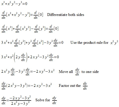

I am new to calculus. I am doing well in my class. I just have a few questions about implicit differentiation. First, why do we call it "implicit" differentiation?
Also, when we do it, why when we differentiate a term with a "y" in it, why do we have to multiply it by a dY/dX? What does that actually do? What is the point of doing it? Why would it be wrong to not do it?
Here is an example in the attached image:
Implicit differentiation means we have a function ##f\, : \,\mathbb{R}\longrightarrow \mathbb{R}##, say ##y \longmapsto f(y)##. The derivative is ##\dfrac{df}{dy}## and nothing implicit happened up to here. Now what if ##y=g(x)## is itself a function ##g\, : \,\mathbb{R}\longmapsto\mathbb{R}##. Then we have ##x \longmapsto g(x) = y \longmapsto f(y)## and ##\dfrac{df}{dy}## doesn't tell us how ##f## changes with ##x##. So we do some quotient algebra: ##\dfrac{df}{dx} = \dfrac{df}{dy} \cdot \dfrac{dy}{dx} = \dfrac{df}{dy}\cdot \dfrac{dg}{dx}##. The first factor is the derivative of ##f## as we started with, according to the variable ##y##, and the second factor is the derivative of ##y=g(x)## according to the variable ##x##. Together we have ##\dfrac{df}{dx}=f\,'(y)\cdot g'(x)##. It is called implicite, since the function ##y=g(x)## is nested in ##f##. The variable of ##f##, which is ##y##, depends implicitly on the variable ##x## via the function ##g##.
Because we have an equation in which one variable, say y, is not explicitly given as a function of another variable, say x. For example, in the equation ##x^2 + y^2 = 4## we can treat y as if it were a function of x, even though we have no equation that directly relates x and y; i.e., we don't have a formula that gives a y value for a given x value. That would be an explicit ("explained") relationship between the two variables rather than the implicit ("implied") relationship in the equation I wrote.
Because of the chain rule.
If I use implicit differentiation with respect to x on the equation I wrote above, we have ##\frac d{dx}(x^2 + y^2) = \frac d{dx}4##, or ##2x + \frac d{dx}(y^2) = 0##.
To get the remaining derivative, use the chain rule like so: ##\frac d{du}u^2 \cdot \frac {du}{dx}##, where ##u = y^2##.
We end up with this equation: ##2x + 2y\frac{dy}{dx} = 0##. If necessary, we can solve for ##\frac{dy}{dx}## algebraically.
I've skipped a few steps, but I hope you are able to follow my explanation.
It is called implicit because we are not given an explicit equation ##y=f(x)## which we are able to explicitly differentiate with respect to x. Instead we are given a perplexed equation ##f(x,y)=0## (like ##x^2+y^3x=0## for example) which we can explicitly differentiate the terms involving ##x## (differentiation with respect to ##x## always) and implicitly differentiate the terms involving ##y=y(x)## using the chain rule as follows $$\frac{dg(y(x))}{dx}=\frac{dg(y)}{dy}\frac{dy}{dx}$$
where ##g(y)## is any function of y like ##g(y)=y^3##. I believe the above answers your second question also as to where the term ##\frac{dy}{dx}## comes from. It comes from the application of the chain rule of differentiation.
