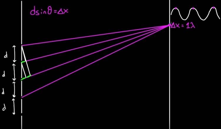

I’ve been wachting a video here on interference maxima when light passes a grating and 3 questions came up.
1.
The lecturer shows the following picture:
He mentions that each purple line from each slit (distance ##d## apart) that meet at the same point on the right side (for constructive interference), will be longer than the previous purple line by whole integers of ##λ## (small green lines). However, isn’t this only the case when the purple lines are parallel to each other? You’ll notice that the further away the purple lines are, the sharper their angles are with the slit line so that the proportionality with nλ will not hold. Perhaps this is all neglectable but in the case of precise measurement, is my reasoning correct?
2.
If all purple lines need to be parallel to each other for them to be longer than the previous one by whole ##nλ##’s, how will they meet at the right side to make a constructive interference in the first place? They’re parallel to each other.
3.

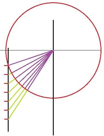

Since parallel lines don’t meet at the right side, if one truly wants to seek an angle of any purple line that is a distance of ##nλ## longer than the previous ones, while meeting at the right side in 1 point for a constructive interference, shoudn’t one use the very first purple line as a radius of a circle instead of drawing a triangle and solving for ##sin^{-1}(λ/d)##? Like this:
Where the green lines are longer by nλ with respect to each other? In this case one would have to find an equation that shows a relation between the length of the green lines and the angle from the circle center w.r.t. the angle of the first purple line. Nevertheless, for very precise measurement, is this reasoning correct?
Correct. The usual derivation is for ##\theta << 1## .
Likes JohnnyGui
The assumption is OK as long as the angles are all small enough. The lines that are chosen for the diagram will not actually be the paths that are followed from slots to any particular point on the screen. The light spreads out in all directions from each slot - particularly for very narrow slots, which have individual diffraction patterns which are pretty much equal amplitude in all of the forward facing sector. The overall pattern is the product of the slit pattern and the array pattern and wide slits will impose a variation of amplitudes of the fringe maxima. See this link for an idea of what I am getting at.
It is easier to identify the nulls than to identify the maxima in such a pattern,. For the nulls, the path differences are an odd number of half wavelengths.
The interference pattern for a number of slits greater than two will only have sharp nulls in the 'near field'. where the paths cannot be considered to be parallel and your 'circle' diagram shows it well. The nulls will be 'filled in' because the path differences at points on the screen are never quite right. Twi slits will give good nulls even in the near field.

Thanks for the explanation. So I take it my circle diagram shows correctly/more precisely how much each path increases in length (green lines) the further it's away from the given maxima?
Usually this is shown with the purple lines parallel to each other, which, as you assumed, is the correct situation. Then a lens is placed to the right of the slits and the lines converge on a screen a focal length away.

I understand. But what I merely wanted to know is if my reasoning is correct of how the length increases the further away a line is. Would my radius method be more accurate to get the angle compared to when using the sine method of triangles?
I am not sure what your "radius method" is for - except to exaggerate the path differences for the purpose of a qualitative demonstration. The angles don't count here; it's the path distances between slits and screen point that you use to find the sum of the contributions at any point. It's a Pythagoras job to work out the paths to get the phases. Introducing your radii just means more calculations.
This sort of thing is easy on a spreadsheet and you can get a graph of the resultant amplitudes. Then you can see how the pattern goes from far field to near field as you vary the throw of the rays.
Exactly, so using the radius approach to calculate the increase in lengths of the paths as they're further away should yield the same result as when using pythagorean theorem, albeit in a more complex way? All I want to know is if this radius approach shows the correct increase in path lengths as any other precise measurement.

How would you envisage calculating the lengths outside the circle? I couldn't think of a way that wouldn't involve knowing the total distance to start with.
Indeed, just noticed that you'd need the initial distance of the circle radius to begin with which is dependent on where the next maxima is that you're trying to calculate in the first place.
