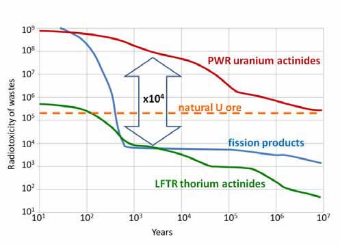

The benefit of the LFTR is that fission products are removed and the Th-based fuel cycle does not accumulate as much TU as does the U-based fuel cycle. However, the LFTR system does require a reprocessing system that will accumulate the U-233, recycle the Th-232, and accumulate the fission products that then have to be fabricated into a safe form (typically encapsulated ceramic). The waste forms then have to be cooled.
