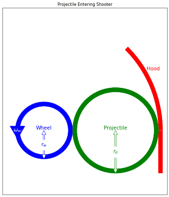

now lets think about how we can do this tangentially, assume this time that I got a spinning wheel that will touches a projectile (could be any but I'll refer to a ball) also imagine we got a nice hood as in the picture bellow so that the ball can't just leave the moment a force is applied
also assume the wheel doesn't have to touch the projectile tangentially like in the diagram (but if you treat it one way or the other please do elaborate on why you chose the amount of compression you chose) and that the hood has some friction so that the ball also rolls against it due to the wheel pushing it (again if you have any insight on what hood friction differences do tell).
how would the surface collision like in example 2 work on a wheel (which has infinite sides) work? if I gave you a known projectile which you know everything about and told you to shoot it for me at x velocity, how would you change the wheel variables and why?

this model could somewhat work with 1 type of mechanism: the hooded flywheel shooter (assuming friction is static only of course)
Is it like the photo in https://en.wikipedia.org/wiki/Pitching_machine ?
Here just weight of ball is not enough to keep touching the roll. Ball is pinched and pressend between the roll and the hood to keep touching the roll. By putting the hood and ball inlet downside of the roll, where graivity jamms the ball to contact to the roll but the hood urges to do it, the machine could be used for "under throw" pitch.
pretty much yes, the gravity part of your description I am not sure, since the shooter usually "raises" the ball with it while in contact (so the release angle is where the ball starts from in the picture you shared but the ball starts from further down). during contact the ball usually rolls against the wheel/hood too though.

The simple answer is
[tex]v=R\omega[/tex]
where v is tangential speed of released projectile, R is radius and omega is angular velocity of wheel.

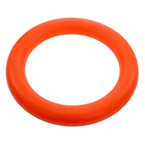

View attachment 1729619454025.webpyou need to shoot this torus , it has a 25 cm inside diameter, 36 cm outside diameter, 5 cm thickness and weights 255 grams.
and I want to shoot it at lets say 30 m/s preferably with spin. I need to shoot 1 every 8 seconds.
Here is the problem with the wheels: you are supposed to just choose or make your own wheels.
There isn't really guide on this part so I'm not sure how I can give info on this.

the only other constraints/goals I can think of are that the shooter itself should be able to rotate around an axis and be able to choose lower velocities, but all of that isn't really a problem and could be solved quite easily.
as for the easy conceptually part, please elaborate, because to me it isn't that simple.
so here are some questions I have about this:
would you put your wheels on the top so they grip the top of the torus or on the sides?
what about opposing wheels such as on the bottom or other side?
how much would you choose to compress the torus*? (either from the side or from the top/bottom)
do you think contact area or contact time with the torus is at all important?
how much do you think spin will be important?
*since I can't give you any information about its elasticity just choose one that will work for you.

cardboard_box said:
yes that makes sense, but that also means that the contact area of the wheel with the projectile just doesn't really matter
That is a weird reply to a post that had nothing to do with contact area, but was about velocity. You seem to be all over the place.
In any case, the simple model of friction, that is independent of velocity and contact area is just an approximation. It doesn't necessarily hold over arbitrarily large ranges of these variables, and for arbitrarily short interactions.
  • #35
yes, let me give a hopefully better example, if we are using a linear shooter (2 counter-rotating wheels and the projectile in the middle) then we add another set of wheels (fully identical to the first set with same RPM and everything). it really shouldn't matter at all to the final velocity of the projectile, that seems a little counter intuitive since there are more wheels pushing on the projectile. similarly it means you don't really need both wheels to "push" since it can't exceed maximum surface velocity anyways.
I doubt any mechanism in my range of building get to large enough velocities or contact areas for it to matter.
