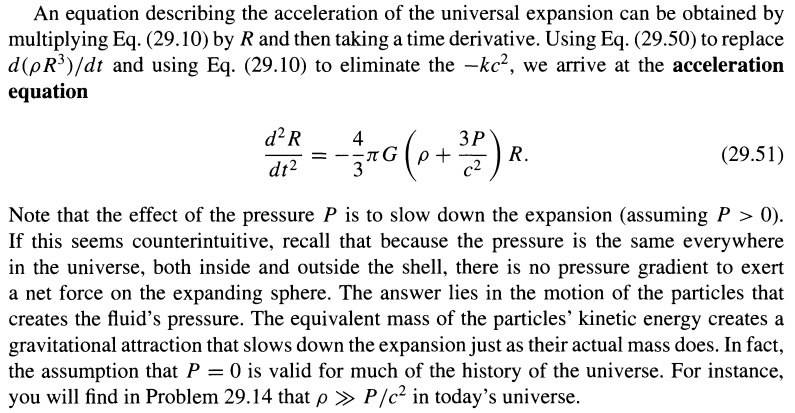

In the book(An Introduction to Modern Astrophysics - Bradley W. Carroll and Dale A.Ostile)
Pressure P = equivalent energy density of kinetic energy
P/c^2 = equivalent mass density of kinetic energy
Isn't the pressure P in the acceleration equation the equivalent energy density of kinetic energy?

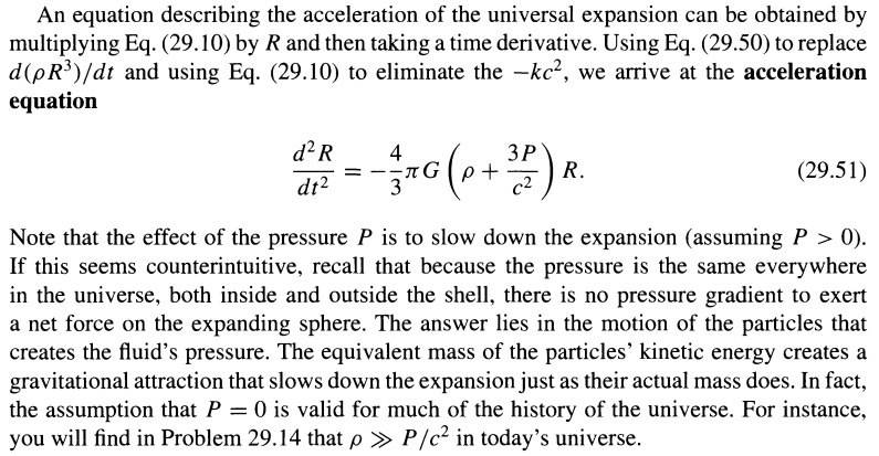

Dark energy is not caused by a song on the Mason Williams Phonograph Record.
I already answered this. No.

No. I'm not familiar with the textbook you referenced, but I would say the passage you quoted is badly worded. The "equivalent mass of the particle's kinetic energy" goes in the mass density (or energy density, depending on which units you use) ##\rho##, not the pressure ##P##. The pressure ##P## is the force per unit area exerted by one parcel of fluid on another (assuming we are talking about a perfect fluid). Pressure does appear in the stress-energy tensor and in the "source of gravity" term in the Friedmann equation, but it is not the same as "equivalent energy density of kinetic energy"--kinetic energy goes in ##\rho##, not ##P##, as above.
