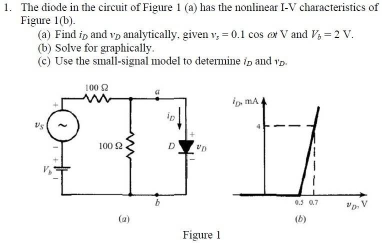

For question 1, it asks me to find the operating point by different methods.
But I have no idea to solve it. Can anyone give some hints for me?
I can just think about the diode can be replaced by an ideal diode, a 0.5V dc source and a 0.2/4=0.05Ω resistor.

1(a):
Write the linear equation relating vD to iD.
Sum currents to zero at vD. Solve for vD.
Solve for iD.
The rest I leave to you.

I disagree with your instructor. You do need to assume what Vbe is (0.7V is a good assumption) in order to compute Rb.
I do not get the meaning of this sentence...
Besides, should I ignore the ac power source in (a) and (b)?
Then I can convert the circuit into Thevenin equivalent circuit and Norton equivalent circuit to get the load line to solve the problem in (b). Is it right?

vd is a node. The sum of all currents entering (or leaving) a node = 0.
No, you should not ignore the ac source. It is a source of current to the node vd, along with Vb.
I don't know why you would want to convert to thevenin equivalent circuits. For one thing, the id - vd relationship is nonlinear.
Once you have solved part a) you have an expression for vd. You can take this function of time and plot it on the vd axis, then see the id on the y axis.

Does it mean that I can only get the result with no cos(ωt) in (b) but not (a)?
When I use the result in (a) to draw the line, I found that there may be something wrong in my calculation as the my calculated vd is in a small range near 0.5V...
[itex]i_D=20v_D-10[/itex]
[itex]\frac{v_s+v_b-v_D}{100}=i_D+\frac{v_D}{100}[/itex]
[itex]0.1cos(\omega t)+2-v_D=2000v_D-1000+v_D[/itex]
[itex]0.1cos(\omega t)+1002=2002v_D[/itex]
[itex]v_D=5.00\times 10^{-5} cos (\omega t)+0.500[/itex]
[itex]i_D=20v_D-10=9.99\times 10^{-4} cos (\omega t)+9.99\times 10^{-3}[/itex]
Is there any wrong?
Is there any wrong?
Yes, the first line.

Oh, I found the problem.
It should be
[itex]i_D=0.02v_D-0.01[/itex]
[itex]0.1cos(\omega t)+2-v_D=2v_D-1+v_D[/itex]
[itex]0.1cos(\omega t)+3=4v_D[/itex]
[itex]v_D=0.025cos (\omega t)+0.75[/itex]
[itex]i_D=20v_D-10=5\times 10^{-4} cos (\omega t)+5\times 10^{-3}[/itex]
Is it right?
If yes, then how can I solve it graphically by the results?

I thought you already outlined your approach, back in what I quoted here.
Should I solve (b) with dc load line only? As the ac part of Vth is quite small...
Vth=0.05cos(ωt)+1V
Rth=50Ω
Or I should draw a line with Vth=0.05+1V and a line with Vth=-0.05+1V?
I think the question would be answered by drawing the DC load line, then showing a swing around it of 0.05V. So that could be thought of as drawing 3 lines―one solid line and a dotted line either side.

In (c), I first consider the dc source only and do the similar with (a) and found
Vo=0.75V, Io=5mA
In small signal model,
[itex]r_d=\frac{1}{\frac{d i_d}{d v_d}}=\frac{1}{0.02}=50\Omega[/itex]
[itex]v_p=0.1\times \frac{100||50}{100+100||50}=0.025[/itex]
[itex]i_p=0.02v_p-0.01=5\times 10^{-4}[/itex]
[itex]v_D=v_p cos(ωt)+v_o=0.025cos(ωt)+0.75[/itex]
[itex]i_D=i_p cos(ωt)+i_o=5\times 10^{-4} cos(ωt)+5\times 10^{-3}[/itex]

Maybe also draw an expanded graph about the area of interest, so that the magnitude of the output sinusoid can be measured directly off the graph, since this part is supposed to illustrate the graphical method of determining output.

I don't follow the - 0.01 bit.
I just get equation from the I-V characteristic graph and find that
