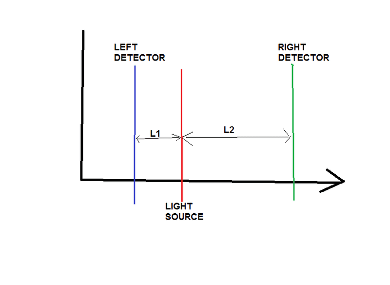

Dale said:
The light arrives at each detector at a different time.
This is how I at first look at this; fur sure light need more time to reach detector that is moving away for it, because light must travel longer distance to reach this detector.
From frame at rest, distance L2 is longer then L1. So I would say distance "change" and that is reason why light need more time to reach right detector.
So light has speed c in both direction, time is absolute, but distance is changed in frame at rest.
Where I am wrong?
  • #36
John Mcrain said:
Where I am wrong?
Right here:
John Mcrain said:
time is absolute
The derivation clearly shows that time is not absolute.
Clearly. And that fact is why the time is not absolute.
In the end, the point remains: two events that are simultaneous in one frame are not simultaneous in another frame. This is the relativity of simultaneity. The fact that the distance changes in one frame and doesn't change in the other frame in no way implies that the conclusion doesn't hold. Quite the opposite, it is the reason that the conclusion does hold.

  • #39
Dale said:
Please work through the math in post 15. It is laid out there. If you don't understand a specific step, please let me know and I can expand on that step.
But this thing dont need math is it pure logic(obviusly my is wrong, but cant find why)
If I can explain why light need more time to hit right detector,only with "change in length", why do I need talk about time?
  • #40
Math is logic. Nothing can be more logical than math.

I also notice that distance is changed looking from rest frame because the fact light has constant speed.
does that tell me something about time?
hm maybe like this:
c=d/t,
I first conclude d increase, so to keep c=const, I must increase t as well, that is proof that time also change.
Is this OK?
That is pretty much why I made that comment in my previous post about people "insisting that the math should conform to their misunderstandings instead of allowing it to guide their understanding."
Your use of natural language instead of math is allowing you to start reasoning from false premises about the nature of time; naturally even valid logic applied to false premises will lead to invalid conclusions.
To repeat something from an even earlier post of mine in the thread: Learn to use the Lorentz transformations and Minkowski spacetime diagrams. If you were taking a proper physics class, at some point your professor would make you go through the exercise of describing this train/source/detector problem by drawing spacetime diagrams and labeling each event with their x and t coordinates.
Likes russ_watters and Dale
  • #44
Logic is part of math. Please study the math in post 15. It includes the logic.
I feel like you asked me to do an example for you and then you have done everything you can to avoid studying the example you asked for. It is a bit frustrating. Why ask me to go through the non-trivial effort of working out an example of you didn’t want to study it in detail?
Because your “change in length”, together with the invariance of ##c##, logically leads to the relativity of simultaneity anyway.
