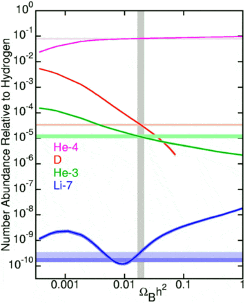

In that case he and I discussed the abundances of elements as being a kind of forensic observation of conditions prior to the CMB wall.
Yes, that's a valid way of describing it. We can't see directly past the CMB using electromagnetic radiation (although if we figure out how to detect neutrinos or gravitational waves from earlier times, that would give us a way of seeing to those earlier times), but we can infer what conditions were at earlier times based on other observations.
