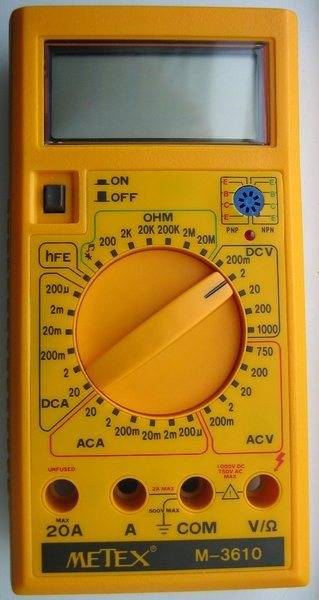

Borek said:
Actually - do both :wink: I have an older multimeter with a separate on/off switch and dial for function selecting.
Picture? I have only ever seen the new age easy to use ones. What does vintage feel like:cool:?
Likes davenn
It is actually not THAT old, I got it second hand somewhere in nineties but I don't think it was older than 2-3 years at the time.
(Image stolen, no time for taking pictures ATM)

all my digital ones (4 or 5 different models) all have an off position on the rotary switch
eg my Fluke meters. My Fluke 87 is more than 25 yrs old
this is the model ( but not my well worn one haha)
many of the modern ones have a separate power switch
modern one with a separate power switch ...
ohhh I have one of them too ... different brand name on it
Yup both of mine have a separate power switch.
