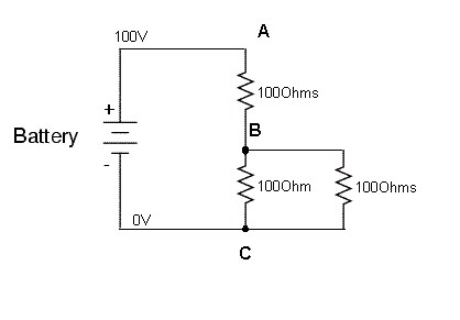

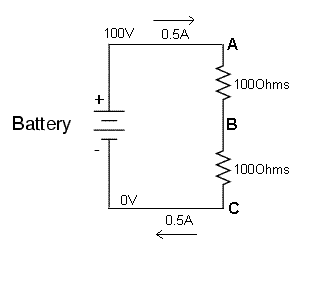

take a basic voltage divider cct
simple maths tell us that, because the resistor values are equal, the voltage at point B will be 50V ( 1/2 the supply voltage)
now add another 100 Ohm resistor as a load and you can see that the total resistance between B and C has now changed
and this is going to completely alter the respective voltage drops across the to resistor and the paralleled bottom pair
and also change the current. And any minor changes of that 100 Ohm ( right one) is going to continuously change the whole set up

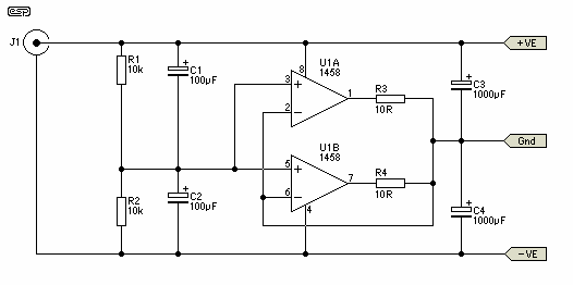

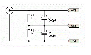

one thing I forgot to mention the other day about voltage dividers is and is REALLY handy if you need a basic split rail supply
from a battery or other single rail source ...
another of my quick drawings ...
Dave
