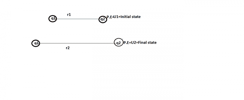

Consider a system of two charges ## q_1## and ##q_2## separated by distance ##r_1##.This configuration is associated with a potential energy ##U_1##.When the separation is increased to ##r_2##.Potential energy becomes ##U_2##
##dW_E##=##\vec{F}##.##\vec{dr}##
##dW_E##=##Fdrcos0##=##\frac{1}{4πε0}\frac{q_1q_2}{r^2}##dr
⇒##W_E##=##\int_{r_1}^{r_2}####\frac{1}{4πε0}####\frac{q_1q_2}{r^2}##dr
##W_E##=##\frac{-q_1q_2}{4πε0}####[\frac{1}{r_2}##-##\frac{1}{r_1}]##
By definition of potential energy ,
##U_2##-##U_1##=##-W_E##
⇒##U_2##-##U_1##=##\frac{q_1q_2}{4πε0}####[\frac{1}{r_2}##-##\frac{1}{r_1}]##
Taking infinity as reference i.e ##r_1##=∞ and ##U_1##=0
⇒##U_2##-0=##\frac{q_1q_2}{4πε0}####[\frac{1}{r_2}##-##\frac{1}{∞}]##
⇒##U_2##=##\frac{1}{4πε0}####\frac{q_1q_2}{r^2}##
Taking ##U_2##=##U## and ##r_2##=##r_1##
##U##=##\frac{1}{4πε0}####\frac{q_1q_2}{r}##
I want to ask as we can see ##r_2 ##is >##r_1##
and then problem assumes ##r_1## to be ∞ my question is what is ##r2## then?how can ##r_2## be greater than ##r_1##?How can any number be greater than infinity?
The only place where I see an assumption that r2 > r1 is in the limits of integration in ##W_E =\int_{r_1}^{r_2} \frac{1}{4πε0}\frac{q_1q_2}{r^2}dr##
But that is not an assumption that r2 > r1. You can evaluate an integral from a larger endpoint to a smaller. The result is the negative of the same integral evaluated from smaller to larger.
This is what we see looking at the figure, yes.
Yes, now they want you to imagine increasing ##r_1## so that it's not only bigger than ##r_2## but bigger than any value of ##r## you can imagine.
They replaced ##r_2## with ##r##, meaning that instead of thinking of it as a fixed value for the separation distance, it's now thought of as a variable.
It can't. Very poorly authored example, if you ask me.

But they don't want to increase ##r_1## such that distance between them becomes greater than ##r_2## instead they want to increase ##r_1## such that distance between them becomes ##r_2##
Unless you have mistyped the final equation, it contains r, not r1. So it's a misprint: they mean replacing r2 with r.
Yes.
It isn't. When you write an integral from a to b, there is no requirement for b to be greater than a:
##\int_a^bf(x)dx = -\int_b^af(x)dx##

Yes,you have told me once.Upper and lower limit just indicate final and initial positions but this line confused me
Ok, but the equation is valid either way. With hindsight, the author might have preferred to write "changed to r2".
