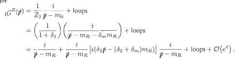

I have yet another question concerning these same http://isites.harvard.edu/fs/docs/icb.topic521209.files/QFT-Schwartz.pdf, this time on page 192 concerning (19.34).
Simply, how do I get from the lhs to the rhs of (19.34). I know that is just a Taylor expansion in delta_2, but I can't see how this ends up in the expression on the rhs.

A bit embarrassed to come back, but concerning my question in post 5 and ChrisVer answer in post 6, I am confused what Schwartz does in the textbook what is a bit different from what goes on in its notes
with
and
If I expand and multipy as shown in post 6 of this thread, then how do I get the m_r in the denominators? As I understand after exanding and multiplying I have everywhere m_0. After that II can set
, but that would not look like the last line given here.
Any help?
THANKS!
I don't remember how to use slash notation, so I'll write just p ,denoting p-slashed
[itex] \frac{1}{1+ \delta_2} \frac{ i }{p - m_R - \delta_m m_R} [/itex].
[itex] (1 - \delta_2) \frac{i}{p - m_R} \frac{1}{1 - \frac{\delta_m m_R}{p - m_R}} [/itex]
[itex] \frac{i}{p-m_R} (1- \delta_2) ( 1 + \frac{\delta_m m_R}{p-m_R})[/itex]
[itex] \frac{i}{p-m_R} + \frac{i}{p-m_R}\frac{\delta_m m_R}{p-m_R} - \frac{i}{p-m_R} \delta_2 - \frac{i}{p-m_R} \delta_2\frac{\delta_m m_R}{p-m_R}[/itex]
time to drop things that are not-needed...
The first term= your first term ... the rest is so:
[itex]\frac{i}{p-m_R}\frac{\delta_m m_R}{p-m_R} - \frac{i}{p-m_R} \delta_2 - \frac{i}{p-m_R} \delta_2\frac{\delta_m m_R}{p-m_R}= \frac{i}{p-m_R} (\delta_m m_R - \delta_2 \delta_m m_R) \frac{1}{p-m_R}-A[/itex]
Where [itex]A = \frac{i}{p-m_R} \delta_2 = \frac{i}{p-m_R} \delta_2 \frac{ p - m_R}{p-m_R}[/itex]
Inserting this [itex]A[/itex] above you obtain:
[itex]\frac{i}{p-m_R} (\delta_m m_R - \delta_2 \delta_m m_R- \delta_2 (p -m_R)) \frac{1}{p-m_R}[/itex]
So far I've been dragging the [itex]\delta_2 \delta_m[/itex] for too long, it's time to drop it out, since it's a second order (delta squared) contribution...
[itex]\frac{i}{p-m_R} (\delta_m m_R- \delta_2 (p -m_R)) \frac{1}{p-m_R}[/itex]
[itex] \frac{i}{p-m_R} ( - \delta_2 p + (\delta_2 + \delta_m) m_R ) \frac{1}{p-m_R} [/itex]
[itex] \frac{i}{p-m_R} ( i^2 \delta_2 p - i^2 (\delta_2 + \delta_m) m_R ) \frac{1}{p-m_R} = \frac{i}{p-m_R} ( i \delta_2 p - i (\delta_2 + \delta_m) m_R ) \frac{i}{p-m_R} [/itex]
or finally what you have:
[itex] \frac{i}{p-m_R} ( i[ \delta_2 p - (\delta_2 + \delta_m) m_R ]) \frac{i}{p-m_R} [/itex]As an overall note, by what I understand that is your problem, you needed to expand in the deltas... in other words if you have:
[itex] \frac{1}{1+a + x} [/itex] and you want to expand wrt to [itex]x[/itex], the common way to do that is by taking [itex]1+a[/itex] as a common factor out, so you have:
[itex] \frac{1}{1+a} \frac{1}{1+ \frac{x}{1+a}} [/itex]
and then you can expand the second fraction in terms of x...
Here you expand in deltas...
Likes Lapidus and vanhees71
