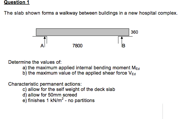

1) The slab shown forms a walkway between buildings in a new hospital complex (Please consider it as the sketch below).
________________________________360
^| A......780...|^B
Determine the values of:
a) the maximum applied internal bending moment
b) the maximum value of the applied shear force V
Characteristic permanent actions:
c) allow for the self weight of the deck slab
d) allow for 50mm screed
e) finishes 1 kN/m^2 - no partitions
Question 2

I'm afraid your sketch of the slab needs some explanation.
please refers to the attachment shows the drawing for question 1

This is apparently based on Eurocodes. There is a general lack of explanation of your figures and some obvious errors, such as N/m2 should be kN/m2? How do you get from Qk to qk? As most of us don't have EC2 to hand, you need to explain (for example) the line for Gk =0.36(78). What it needs is a small sketch or calculation that follows from the numbers given. It is good that you have made your references, but for Physics forum help, you need to give thoughtful explanation of your work, and identify where you want help. The bending moment is a bit mysterious, because you appear to have assumed that there is a cantilever, when a simply supported slab is more likely. Your incorrect units for both bending moment and shear force suggest either that you haven't understood the concepts of M and V, or (possibly) that you are working 'per m width of slab', which is never stated.
