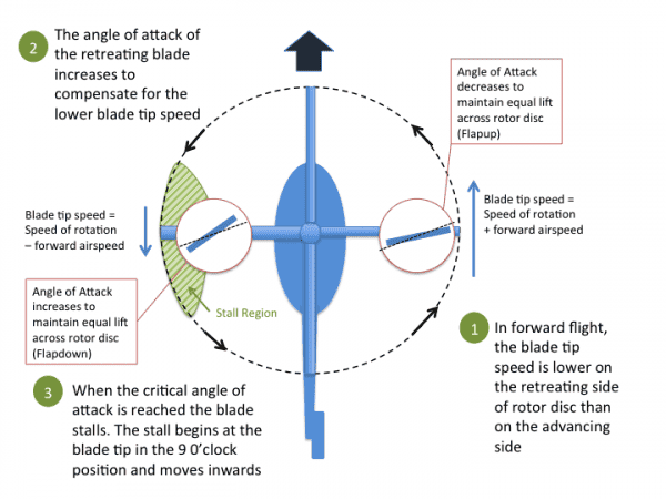

Please see the following diagram below:
The thing that I find puzzling is why does the advancing blade (the right side) decreases the angle of attack while the retreating blade (the left side) increases the angle of attack? Does it have to do with the fact that it is rotating from the right to the left?
The lift generated by a blade depends on its angle of attack (all else being the same more AoA mean more lift until the thing stalls) and its speed through the air around it (all else being the same, more speed means more lift) .
Because of the forward motion of the helicopter the advancing blade is moving faster through the air than the retreating blade. Thus the retreating blade needs more agle of attack to keep the lift the same on both sides.
In that diagram, do you clearly understand the reason behind the difference of the blade tip tangential velocity between 3 o'clock and 9 o'clock?

When you ride a bicycle at a speed of 10, the rubber at the bottom of the wheel is in contact with the ground, so is doing a speed of zero. The axle is moving with the bicycle at a speed of 10, while the rubber at the top of the wheel is moving forward at a speed of 20.
When you hover a helicopter with a blade tip velocity of 300, the blades all have the same tip velocity, from zero at the centre to 300 at the tip.
Lift from an airfoil or a rotor blade is a function of airspeed squared, but lift is also related to angle of attack.
When that helicopter flies forwards at a speed of 100, the blade tips on the right are moving through the air at; 300 + 100 = 400; while the tips on the left have an airspeed of only 300 - 100 = 200.
Due to blade airspeed, the lift from the tips on each side of the helicopter rotor will differ by, 400² to 200²; a ratio of 16:4 or 4:1.
Now consider the part of the blade that does most of the work, at about 2/3 of the tip radius. When hovering the blade speed at that point will be 300 * 2/3 = 200;
When the helicopter is flying forwards at a speed of 100, the blade airspeed on the right will be; 200 + 100 = 300, while on the left it will be, 200 - 100 = 100; which is there a ratio of 9:1.
The helicopter cyclic control makes it possible to cyclically change the blade angle of attack during the rotation, so as to balance the lift from the blades on the two sides of the rotor.

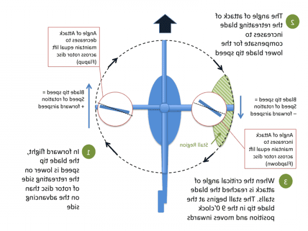

Interesting comparison! So, what would be the case if the blade was rotating from the left to the right?
* Note: I flipped the image in the opposite direction for you to see.

I'll admit I am somewhat confused because I am attempting to understand why on the left rotor the speed is less. I get that the left side of the blade is the retreating blade because it is moving away from the helicopter, but if you were to move the retreating blade in the opposite direction, would it make any difference?
Please read about P-factor here:
http://www.av8n.com/how/htm/yaw.html#sec-p-factor
Perhaps we could analyze a regular airplane first.
Have you noted that fixed-wing airplanes take-off and land straight against the wind when possible?
The purpose is to have a higher air speed flowing around the wing.
By doing so, less runway length has to be used; therefore, more safety margin is available if something goes wrong.
The fixed wing does not know or care about its speed related to the ground, that is a business to be attended by the landing gear.
The wing only reacts with a combined lift-drag force to the velocity of the airflow hitting its leading edge.
If the recommended take-off speed is 100 knots (51 m/s), it means that the wing needs an airflow of 51 m/s for safe take off.
No wind means that the airplane needs to roll over the ground at 51 m/s.
A desirable head wing of 6 m/s means that the airplane needs to roll over the ground at 51-6=45 m/s.
A undesirable tail wing of 6 m/s means that the airplane needs to roll over the ground at 51+6=57 m/s.
In the case of our helicopter, the 3 o'clock blade tip is moving through the air in the same direction of the fuselage, only than faster.
That tip does not know or care about the velocity of the fuselage, it only feels a great deal of airflow above and below it; therefore, it generates abundant lift.
Simultaneously, the 9 o'clock blade tip is moving through the air in the opposite direction of the fuselage, only than slower than it (and much slower than the opposite 3 o'clock blade tip).
That tip does not know or care about the velocity of the fuselage, it only feels a marginal airflow above and below it; therefore, it generates poor lift.
Because of the above, the relative-to-the air velocity of the 3 o'clock blade is greater than the relative-to-the air velocity of the 9 o'clock blade.
If we reverse the rotation, the opposite would be true.
In both cases there will be a lack of right-left balance of lift forces, and the helicopter will roll over.
Because there is no much to do about those velocities, which affect the amount of generated lift on a square ratio, as we have discussed above, the only thing to modify in order to regain the needed balance is the angle of attack of the blades as they successively approach the 3 o'clock and 9 o'clock positions.
As we have discussed above, the amount of generated lift depends more or less linearly on the angle of attack (for small angles between 0 and around 10) of a fixed wing or rotating blade.
Using that trick, we want to reduce some the AOA of the faster (respect to the surrounding air) 3 o'clock blade, and to increase some the AOA of the slower (respect to the surrounding air) 9 o'clock blade.
Ah, so that's what I wanted to know. As you said, if you were to reverse the rotation, there would still be an imbalance, in this case, if the rotor rotated from the left to the right, at 9 o'clock it will create more lift, but at 3 o'clock it would reduce the lift, correct?
Likes Lnewqban
