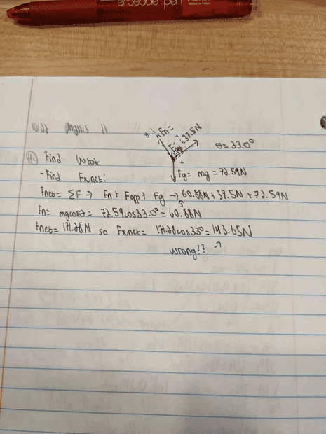

Then, since I'm asked to find Fnet, I tried
Fn = mg*cos(theta) -> (72.59N)cos(33.0) = 60.88N
Fnet = Fg+Fn+Fapplied -> (72.59N)+(60.88N)+(37.5N) = 171.28N
Fx,net = Fnet*cos(theta) -> 171.28*cos(33.0) = 143.65N but this was incorrect.

That's what I'm trying to do. I've attached a picture of the homework, since I forgot to do so, but I'm working through the hints to get to that.

mazia said:
Fnet would be (mg) + Fg + Fapp,
It wouldn't. Some of the forces are horizontal and some are vertical. You just don't add them like that. As @PeroK remarked, a force is a vector quantity. How do you add vectors?

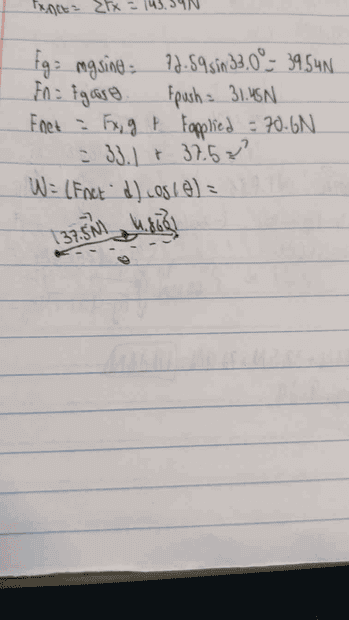

Still got the answer wrong, but here's what I tried.
Fg = mg*sin(theta) -> (7.4*9.81)*sin(33.0) -> 39.54N = Fg
Fn = Fg*cos(theta) -> (39.54)*cos(33.0) -> 33.16N = Fn
Fapplied = 37.5N
Fnet = sum of all forces -> Fg+Fn+Fapplied+Ff -> 39.54+33.16+37.5+0 = 104.15
W = (F*d)cos(theta) -> (104.15*4.860)*cos(33.0) = 424.51 but this is incorrect.

In your first post you calculated ##F_n = mg\cos \theta##. That's the normal reaction force, which cancels out the normal force of gravity ##- mg\cos \theta## on the object. Here we have taken positive to be away from the slope.
The important forces, however, are those parallel to the slope. That includes a component of the gravitational force.

Thank you. So, I took that Fnet, plugged it into the work formula (F*d)cos(theta) -> (70.6N*4.860)cos(33.0) but I still got the answer wrong. I don't understand why I'm struggling so much with this. Thank you for the help so far, though.
This is literally just the hint - I'm not even addressing the actual question yet, I'm just trying to answer the hint. Ugh.
The angle between the force and its displacement is not 33 degrees.

Ohh. So, drawing a triangle with 37.5N being the force and 4.860m being the displacement, I got arccos(4.860/37.5)=82.56degrees... Is that the right train of thought?

I calculated Fnet like we mentioned above, Fx,grav + Fapplied.
I'm learning physics at my university and we're emphasizing on forces and vectors, problem is the homework is through Pearson which does not relate to the lectures/current structure of the course, and I also just suck at physics, so I struggle a lot with the homework.
Your other problem, as I see it, is that you don't relate the physics to reality. The applied force is up the slope and gravity acts down the slope. These forces are in opposite directions, yet you add them together. If we took the applied force to be small, then you would still plug the numbers into the equation and get some speed at the top of the ramp. I.e. you would have gravity accelerating the cat up the ramp.
This physics is not an abstract exercise. It's supposed to model reality. I'm not keen on nonsensical problems like this (pushing a cat up a slope?). If you replace the cat with a box being pushed up a ramp you have something fairly realistic.
You need to develop a physical understanding of this and avoid mistakes like having gravity accelerate an object up a slope with increasing speed.
