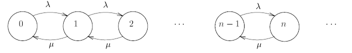

Suppose we have two types of customers, whose interarrival times are exponentially distributed with parameters ##\lambda_1## and ##\lambda_2##.
These customers have to share one server that gives preemptive priority to customers of type 1.
The service times are exponentially distributed with parameters ##\mu_1## and ##\mu_2##.
How can one compute the fraction of time, during which there are no type 1 customers in server+queue given that there is exactly one type 2 customer in server+queue?
I tried to approach the problem via balance equations for the number of type 1 customers, but couldn't figure out a way to implement "having exactly one type 2 customer" into the transition rates.

You need to show your work: what are the balance equations you tried to use?
The unconditioned number of type 1 customers in the system is a Markov chain with the following transition rates:
This yields balance equations ##p_n=\left(\frac{\lambda_1}{\mu_1}\right)p_{n-1}## that are easy to solve.
But, when we condition on there being exactly one type 2 customer, the "observation periods" have different lengths (which is ~##exp(\lambda_2)## for ##p_n,n\in\mathbb{N}## until another customer of type 2 arrives and ~##exp(\lambda_2+\mu_2)## for ##p_0## until either another type 2 customer arrives or current type 2 customer goes through their service) and might not start at "random times", which is causing me problems.

This transition diagram does not include any type-2 customers. I think you need a 2-dimensional diagram with nodes of the form (i,j), i = number of type 2 present and j = number of type 1. You have drawn the diagram for the first "row" (0,j), j = 0,1,2, ... .
Two-dimensional diagram is what I initially started with but it eventually reduced to this, which I thought might be "easier" to solve.

"Easier" ≠ "correct". The type-2 customers make an important contribution to the system: for example, if ##\lambda_2 / \mu_2 > 1## the system will be unstable (having no finite steady-state distribution) even though the type-1 queue might be stable, with ##\lambda_1 / \mu_2 < 1##.

Just to clarify: assuming a stable system and states of the form (i,j), where i = number of type-2 customers present in the system, and j = number of type-1, the two-dimensional transitition diagram can be analyzed using principles of balance, to conclude that the quantities
[tex] p_j = \sum_{i=0}^{\infty} \pi_{i,j}[/tex]
do, indeed satisfy ##\lambda_1 p_j = \mu_1 p_{j+1}##, giving ##p_0 = 1/(1-\rho_1)## and ##p_j = {\rho_1}^j\, p_0, \; j = 1, 2, \ldots .## Here, ##p_j## is the equilibrium probability that there are ##j## type-1 customers present in the system (in queue + in service). However, in terms of the 2-dimensional state space (i,j), you are asked to compute ##P(j=0|i=1)##.
Well, the global balance equations system is as follows$$\begin{cases}\begin{array}{rl}(\lambda_1+\lambda_2)p_{0,0}=\mu_2p_{0,1}+\mu_1p_{1,0}\\(\lambda_1+\lambda_2+\mu_1)p_{i,0}=\lambda_1p_{i-1,0}+\mu_1p_{i+1,0}&i\in\mathbb{N}\\(\lambda_1+\lambda_2+\mu_2)p_{0,j}=\lambda_2p_{0,j-1}+\mu_2p_{0,j+1}+\mu_1p_{1,j}&j\in\mathbb{N}\\(\lambda_1+\lambda_2+\mu_1)p_{i,j}=\lambda_1p_{i-1,j}+\lambda_2p_{i,j-1}+\mu_1p_{i+1,j}&(i,j)\in\mathbb{N}^2\end{array}\end{cases}$$In addition, we have the normalisation ##\sum_{i,j=0}^\infty p_{i,j}=1## and from analysis of queue 1 that doesn't "see" queue 2 we have ##\sum_{j=0}^\infty p_{i,j}=\left(1-\frac{\lambda_1}{\mu_1}\right)\left(\frac{\lambda_1}{\mu_1}\right)^i## for ##i\in\mathbb{N}_0##.
But I still can't see how this whole system could be explicitly solved to obtain ##p_{i,j}## and ##p_{0,1}## in particular.

This is not an easy problem. Perhaps you can try to use multi-dimensional generating function methods, in which you use the balance equations to obtain the mgf

Another approach you might try is to look at the system from the point of view of type-2 customers. They see an M/M/1 queue with server 'vacations'. Vacations are periods during which the server is unavailable = times when it is serving customers of type-1. However, unlike many vacational queueing models, this one let's the server abandon service (to start a vacation) during the service of a customer (if a type-1 arrival kicks out the type-2 customer); most vacational queueing models allow the current service to be completed before the server goes on vacation. Anyway, the length of a server vacation is equal to the busy period of the M/M/1 queue for type-1 customers; this random variable (busy period length) has a complicated, non-exponential distribution involving Bessel functions, although its Laplace transform is not too bad.
Another, related approach is to note that the service time of a type-2 customer will be some very complicated thing consisting of a sum of iid exponentials and a random number of iid type-1 busy periods. (This corresponds to a number if iid exponential attempts, plus a number of type-1 busy periods during our poor type-2 customer is told to go and wait.) I think it might be possible to get the Laplace transform of the type-2 customer service time, and if so, the problem for type-2 customers becomes a simple M/G/1 queue with a horribly complicated service time distribution. However, getting from there to anything like a distribution of the number of type-2 customers present still seems difficult.
I tried the second approach: the busy period ##BP## for type-1 customers has the following Laplace-Stieltjes transform: ##\tilde{BP}(s)=\frac{\lambda_1+\mu_1+s-\sqrt{(\lambda_1+\mu_1+s)^2-4\lambda_1\mu_1}}{2\lambda}## so we can indeed model the type-2 queue as a queue, in which server uptimes are i.i.d. ~##\exp(\lambda_1)## and downtimes have LST above. However, this didn't yield any progress as computing type-2 distribution was too technically difficult.
