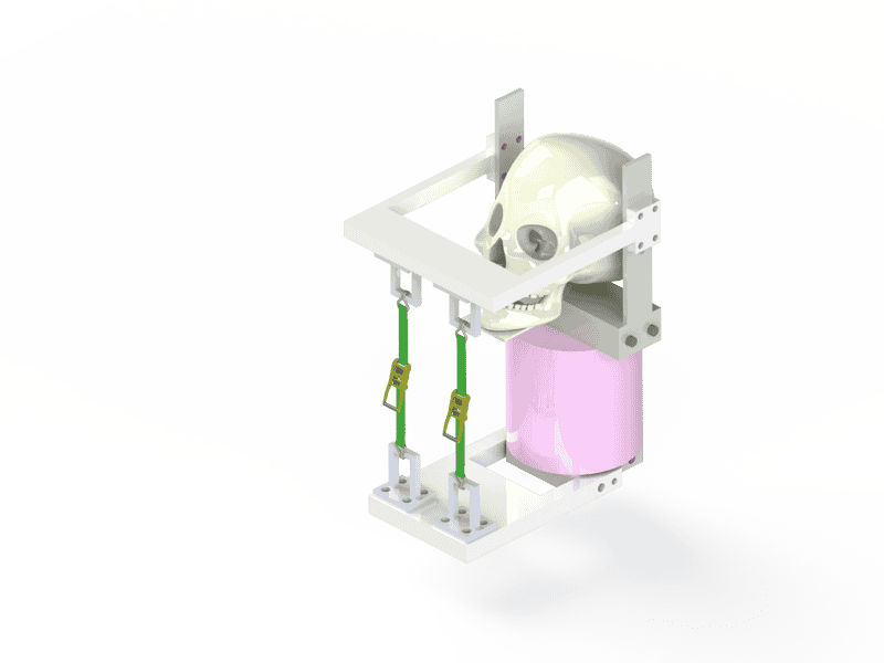

Possibly more relevant to my previous forum:
Going back to my previous idea as in Picture 1 attached, the ratchet strap reduces length between platforms and tilts the head forward. The bottom hook on strap is machined so that it is barely holding onto its anchor. In order to help with consistency of the hook coming off the anchor point to relieve all tension, I believe adding a fixed mechanism as in Picture 2 could help. A horizontal bar/wire (drawn in black) positioned just before the hardstop impacts the lower half of the strap (below ratchet). This will displace that impact point on the strap to the right as we look in the picture, which will accordingly kick the hook to the left as we look, and help it off the anchor point.
If this does work it achieves two things: 1. greater consistency in alleviating tension. 2. release of tension is before impact/hardstop and does not require the impact to release tension (without new bar/wire, hooks coming off anchor is dependent on force generated by impact).
Let me know if you understand this (I gather its very difficult to follow) and if so, do you think this could work / help?

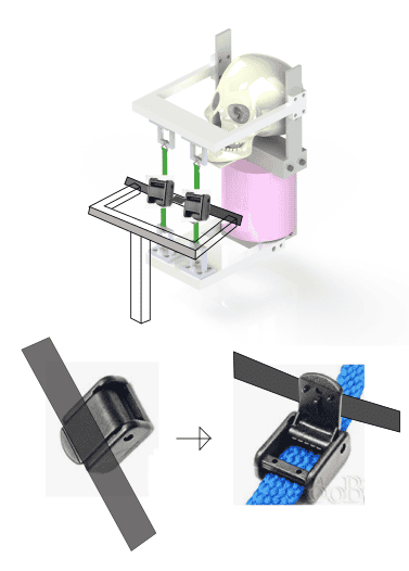

A bit of clarification would be helpful. Is the release to be based on Force or on Position (along the track)?
If Positional release is acceptable, use ordinary cam lock buckles with the release handles facing the trailing end of the sled. With appropriate cord(s) attached to the release handle(s) leading back to the launch point. The cords get tight, open the cam lock buckle, and your the head is free.
I recommend a single release mechanism to avoid problems of trying to get two of them to release at exactly the same time.

@Tom.G The release needs to be solely positional relative to the track i.e. it releases tension at the same point positionally.
I can see the potential of this cam lock buckle idea but don't fully understand. See picture attached.
Is the orientation of the buckle correct? Where does the cord attach to the buckle / how does the tension in the cord release the buckle?
The buckle must be positioned so that the lever you would lift to release the buckle is facing toward the starting end of the track.
Of course the cord(s) must remain slack after they open the buckle until the sled hits the end stop.
Assuming the buckle is on the lower strap, attached to the sled, a few possibilities would be:
1) Make the lower strap long enough to leave slack in the strap + cord(s) at end-of-travel.
2) Attached the fixed end of the strap (right end in your image) to an extension spring. The spring of course would need to be strong enough to open the buckle but weak enough to not materially affect the sled speed.

Cheers for those suggestions Tom, couple things to point out:
I'm unsure on how the buckle could be positioned perpendicular to the direction of the straps threaded through it.
Implementing slack to the straps would be not be possible given their purpose in tensioning to tilt the head forward.
This also affects the cord needing to be slack after opening buckle, not possible?

I'll refer you back to my original idea; the straps, full of tension by ratcheting, have hooks on either end, attached to anchor points as in photo attached. The lower hooks are machined away so that their connection to the anchor is minimal, ready to fall off. When the sled reaches the endpoint, the sudden deceleration and momentum of system will release those lower hooks off the anchor points, alleviating all tension in straps as required. Issue with this is consistency of the release of the hooks, as well as the fact the hooks only release in response to the impact. Ideally, they release just before the endpoint.
In order to increase consistency and attempt to release the hooks before the endpoint, a new idea is to add a fixture just before the endpoint of the actuator (picture 2 drawings in red and black). The straps full of tension collide with a small bar (drawn in black) running horizontally across the track. The tension filled straps will be forced to alleviate this added tension created by the collision with small bar (black) by finding their point of weakness -> the lower hooks barely hanging on, forcing them off their anchor points and relieving all tension.
Let me know your thoughts/questions on this idea.

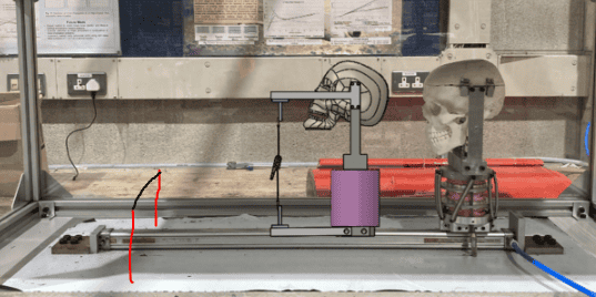

You may have considered this before, but what about just using a taut string that gets cut as the assembly passes a certain point in the track. A sharp pair of crossed razor blades should give you a reliable severing of the string with minimum disturbance of the motion, and very light weight for the moving assembly.

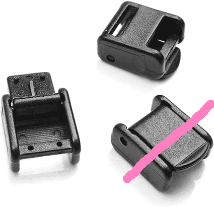

Robbwal199 said:
or if a push button buckle was used and a fixture placed at the end of the track protruded to hit the button (possibly wouldn't generate the localised force needed to push the button properly)
https://www.amazon.com/Buckles-Plastic-Tactical-Backpack-Accessories/dp/B07LGS5WLT?tag=pfamazon01-20
Then attach a piece metal to the handle as shown above in Pink. (You may want the strip of metal wider than sketched though.)
Your fixture at the end of the track could then open the cam-lock buckle.
Have considered this before, but finding a string capable of holding sufficient tension while also being narrow / weak enough to be severed instantaneously is extremely difficult.
Robbwal199 said:
is the picture attached along the lines of what you were thinking of?
Yes.
