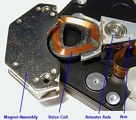

Have you taken apart a disk drive?
The voice coil head positioning actuator seems suited to your distance and speed needs.
There's a lot of them junked, available nearly free.
That actuator contains a great 'fridge magnet that'll actually hold something.

Hi Jim, That is actually where I got the idea from, or at least the proof of concept. I have scrapped many old hard drives and have dozens of those "fridge magnets" (note to any other reader - Don't put them on your fridge without wrapping them in something soft).
I could go and try to find another couple hard drives, pull out the heads and try to arrange them in a manner that will suit my proposes. But to be honest, I am not trying to build something that will just work by hacking things that already work and that I (think I) have a decent understanding of the principals of operation of.
I am trying to apply my knowledge and in the process, develop my understanding. I am trying to build something from first principals that may or may not work work, that way I can figure out why it doesn't work, what I have done wrong and how I cam improve on my understanding.
