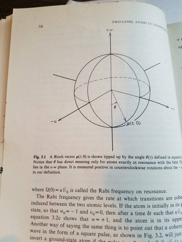

but when I am reading a book by L. Allen "optical resonance and two level atoms" I seem to be getting a factor of two worked in. Hopefully someone here has access to the text and can give me some help. The development is like what's on this wiki page under the semiclassical approach: "https://en.wikipedia.org/wiki/Rabi_problem" but its missing the development on that kE value in the first set of equations. In the Allen book it seems to have a factor of 2 there.
In the book On page 40 he defines a quantity, for kE in equations 2.27. This was part of the optical Bloch equations he derived earlier on page 39. Then later on page 54 I think he says that same quantity is the Rabi frequency. The only difference being that he has made the assumption on page 54 that the quantity is constant in time.

Well, if you have a look at the energy levels of the dressed states at zero detuning where the bare states have the same energy, you will find a certain splitting between these states. Now some authors define the energy difference between the dressed states as the Rabi energy. Others define the energy difference between the bare states and one of the dressed states as the Rabi energy. The difference is exactly a factor of 2.
One can see the definition in the equations afterwards. In the former definition, the time-dependent terms scale as [itex]\Omega_R/2[/itex], while in the second defintion they scale as [itex]\Omega_R[/itex]. What definition one uses is mainly a matter of taste and convenience. In the latter case the probability amplitudes oscillate with [itex]\Omega_R[/itex], while in the former case the actual occupation probabilities oscillate with [itex]\Omega_R[/itex]. Both definitions are commonly used.
