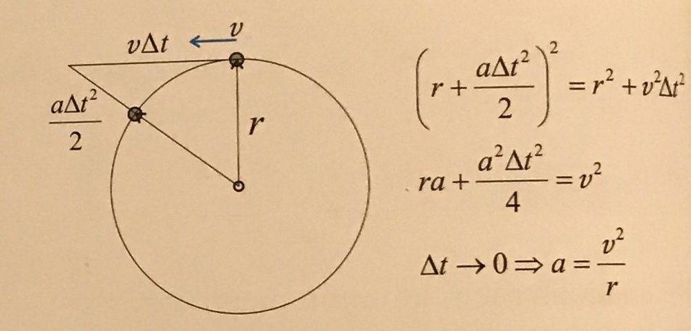

Just started learning about uniform circular motion. I really don't understand how we get aΔt2/2 on the side. I also searched on the internet for a similar derivation, but there are none so simple.
Thanks for your help!
P.S There is a mistake in calculation in second line (textbook error).
bolzano95 said:
I really don't understand how we get ##a\Delta{t}^2/2##
That's just the formula for displacement as a function of time when the acceleration is constant: ##s=\frac{1}{2}at^2##. You'll find many derivations if you google for "SUVAT", or you can work it out for yourself by starting with ##a=\frac{\mathrm{d}^2x}{\mathrm{d}t^2}## and integrating twice.
Sorry, I should be more specific- why do we use aΔt2/2 for the part from the point till intersection with vΔt? As I understand it, we don't look at this problem any more as a rotational motion, but as a straight motion of two points until they intersect.
But why are we looking at this motion from two different starting points? The first would be from a circle and the other one would be from an axis.
This gives me somehow some broken motion I don't quite understand. It becomes a contradiction with my understanding of uniform motion- that it is continuous and "smooth".
I'm trying to understand this without calculus involved :)
I do not understand the formulae either. You should mistrust any textbook that tries to explain physics without the use of vectors.

You can't have uniform circular motion without calculus. Without calculus you can only do something like what is done in the diagram you posted.

I remember when my high school physics teacher gave us this hand-waving argument about the direction of the centripetal acceleration, and it bugged me back then too because there's no reason to think that where the particle ends up on the circle, where the particle would have ended up if it followed the straight-line path, and the center of the circle are collinear. Indeed, it's easy to see that can't possibly be the case if ##\Delta t## is, for instance, one-fourth the period of rotation.
If ##\Delta t## is small enough, though, it's probably a good approximation along with taking the radial acceleration ##a## as constant. Then the correction to ##r## due to the acceleration would be just ##\frac 12 a(\Delta t)^2##. It feels to me, though, that some details are being glossed over, so I could understand why one might remain somewhat skeptical of the derived result.
